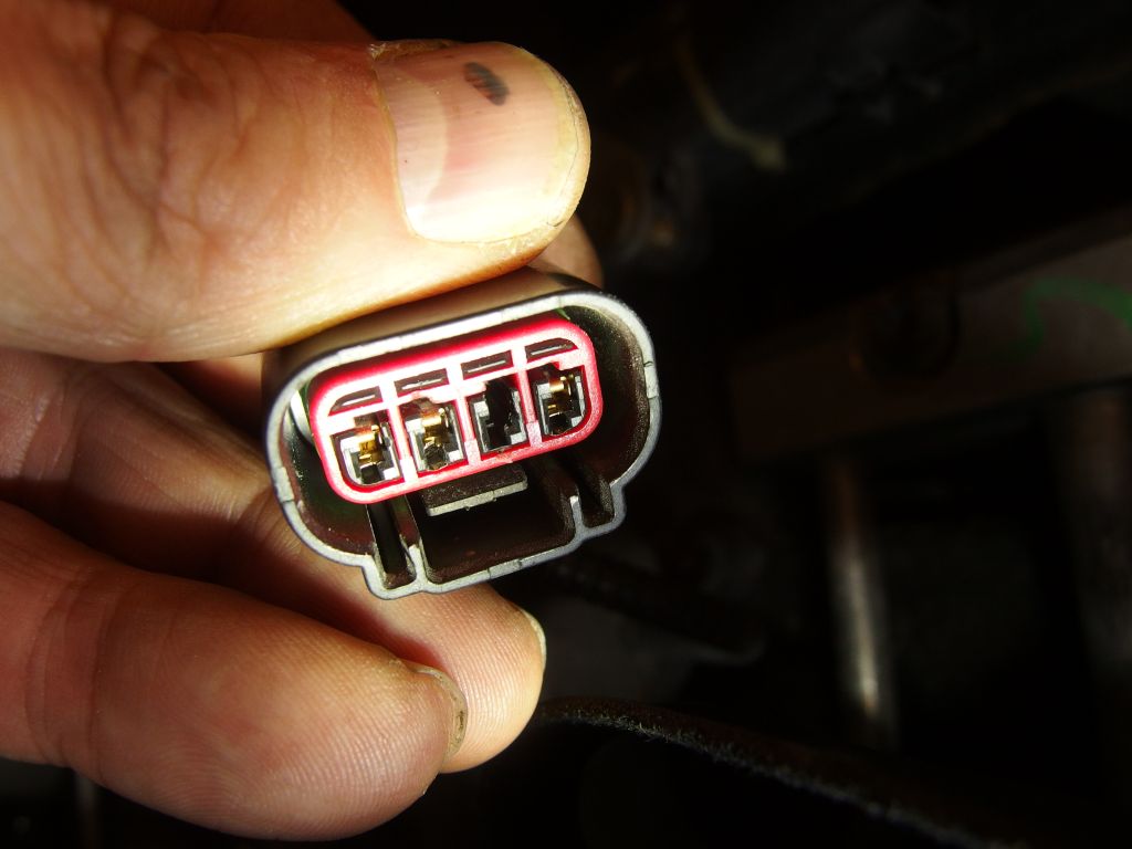

Default One plug wire broke
Thanks for your comments about coolant.
Now finally got the sc out. But. One wire is broken.
Any hints how the insert in the plug comes out? Need to solder the wire back.
Or any other ideas how to get it fixed? Wire got of where it was soldered.

Posts: 84
Received 11 Likes on 10 Posts
I don't know that specific plug, but they're all about the same as far as I've seen. Pull off the red piece then you'll find a small slot at each terminal. Insert a small tool or piece of wire that fits snugly into the slot and push or pull the terminal out. On the terminal you'll find a little tab that locks in the slot, bend it back out a little so it re-locks securely when you assemble. Crimping is better than soldering, but if you must solder use only enough to make it secure and not so much that it wicks up the wire.
As for the goo, I'd hit that fitting with a vacuum then flush water through it and whatever connects to it to get as much out of there as possible.
Edit: give the other wires a test tug to make sure they're ok before you call it done.

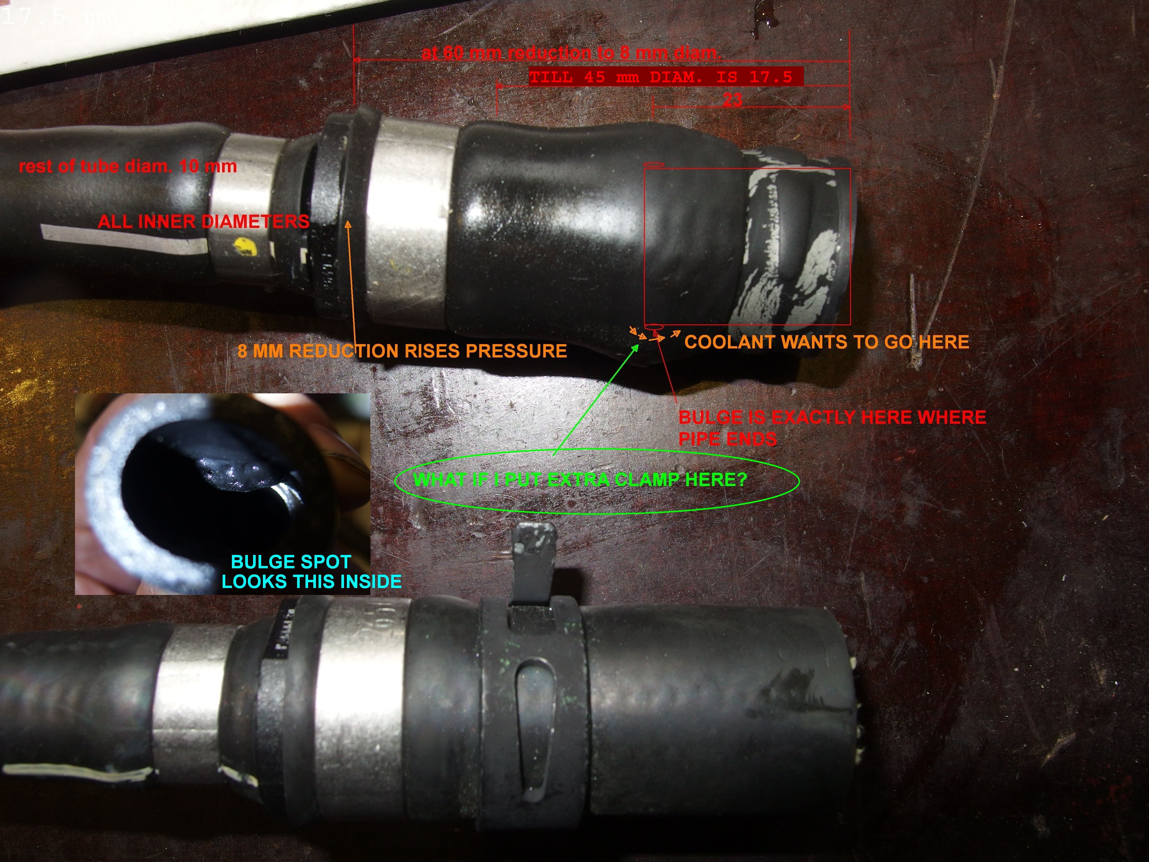

Default Anatomy of this troubled hose
What might be the reason to first have 17.5 mm inner diameter hose and then have reduction to 8 mm and then rest of the hose being 10 mm of inner diameter?
Isn't there pressure rising just in that area where hose is bulging? Causing that coolant want to go like in my drawing?
What do you thing?
What if I put another clamp just over this critical point?
Old 10-15-2015, 01:17 PM
tbird6's Avatar
Join Date: Jun 2009
Location: Home
Posts: 3,899
Received 802 Likes on 670 Posts
Most of them fail in the big section. Within an inch or two of the clamp.
It's a standard ECD (ElectroChemical Degration) failure.
Diagnosing and resolving car coolant hose problems | Gates Europe
Forget the clamp just replace the hose. Not sure why or how Jaguar decided to make that hose that way. I wish they had used a metal tube under the SC and then just a short rubber hose to the throttle body. Would have saved hours of time when replacing it.

I think it would be worth installing a clamp, may not cure it, but would probably help. I'm tackling my SC today for a coolant leak, I'm about 1 1/2 hours in. My hoses were replaced by the PO not long ago, my leak seems to be at the water neck right in front of the SC, unfortunately the space is just a bit too tight to get the neck off without pulling the SC unless I can tilt it up a little.

Old 10-16-2015, 04:03 PM
tbird6's Avatar
Join Date: Jun 2009
Location: Home
Posts: 3,899
No. We have had people use both with no problems. I think you are talking about the URO brand hose?
That port is not a dead end at all and is your intercooler circuit. See that big hex plug on top of it? If you read Jaguar says to unscrew that to bleed the intercooler system. I never have had to because the intercooler circuit always self bleeds for me.
I would flush that very well to get the best cooling you can. We are very heat limited with the M112 blower.
The clamp won't help because the leak is caused by an internal failure. In other words the bulge is the symptom not the problem. So you will get the leak anyway.

Thumbs up Plug is fixed
Yes it was easy to fix after removing the red thing first. Thanks for the hint.
