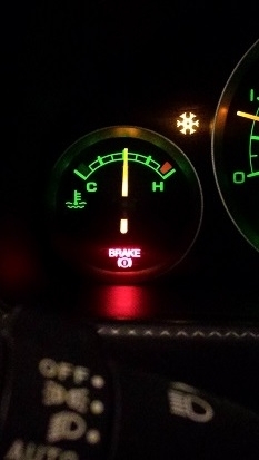

Thirdly take a look at these pics and tell me if this is ok as to where my temp gauge is sitting, while driving it normally stay just under half way, when parked its moves half a millimeter slightly past half way. One picture is from the drivers angle and it looks like it dead on the middle but when I moved the camera straight above the gauge you can see its slightly up.

What year is your S-Type? If you have the ZF 6HP26 transmission (model years 2003 to 2008 in the U.S.), you are likely hearing the infamous "ZF squawk". Do a search here on the forum and you'll read many threads pertaining to it. Your best chance for curing it is an ATF drain-and-fill with the appropriate fresh fluid....
