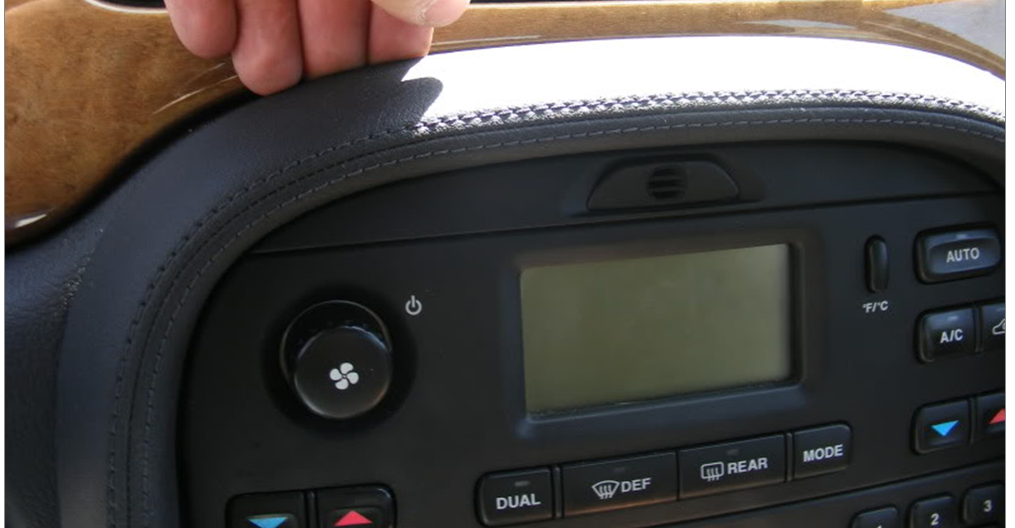

If you have factory navigation you can't replace the radio because no aftermarket head unit can control the Jaguar heating/AC.
If you are really stuck on this it has been suggested that first you convert the car to a factory non-navigation setup and then spend even more money to replace that with an aftermarket head unit.

Yes, you actually CAN.
You need a Climate control module out of a Non Nav car. U dont need the radio or anything bc 99.99% of the nav cars had the alpine system.
So you need a new radio, and at least a 4ch amp, and 2 way crossovers to run the factory alpine speakers, at the bare minimum.
All the speaker wires are in the trunk at the alpine amp harness.
Power wires will be behind the dash at the factory radio location you can use a regular s-type harness. Same with the antenna.
So the only thing that changes is the fact that you have to get a non nav CCM. Other than that, everything is the same as every other non nav alpine equipped STR. I have NEVER seen an STR that didnt come from the factory with the alpine stereo.
I've done stereo installs to varying degrees on many STR's. It's not rocket science. It's just an all or nothing proposition. You either leave it all factory (except for changing the speakers, or adding a sub & amp). OR you rip all the audio electronics out and start again.

So what are going to use to operate the heating/AC?? You need more than the module.
You need the factory non-navigation controls installed and you can only do that IF you DO NOT have factory navigation.
You need this in the dash before you can replace the factory radio.
Attached Thumbnails My new 2003 S Type R and help requested-non-navigation.png
