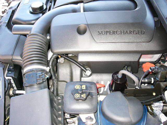

tbird6 will hopefully post details but he already posted about extra wires which for sure do something and I recall a photo I saved

Sorry. Your wrong and so is Car and driver. Here are the pictures to prove it. First you have to actually know what you’re looking at. Then you can easily tell if the engine has VVT or not. Notice the round indentation at the front of the valve/cam covers. This is where the electrical connection for the VVT it located. The first picture below is from a 2003 STR with no VVT. The second picture is from a 2006 STR that HAS VVT. Note also the 2003 has strut tower caps which I have added to my 2005 STR.
Now where all the confusion comes in is the regular non-super charged 4.2L DID have VVT from the begining. Even the factory Jaguar sales literature has to be read very carefully to pull out this fact. I even purchased my 2005 STR thinking it had VVT. Then I compared it to my wife’s 2003 Lincoln LS and found out it did not have it!! So I started looking and finally figured it out.

Hey Tbird,
With the VVT on the '06; in your picture, is the connection for the VVT the wires that are connected at the indentation towards the front of the motor on the valve cover about 3-4 inches from a coolant line?
My '05 motor looks just like the '06 in your picture. Do you have any motor pics of your '05 for comparison?

Iluvmy05STR - yeah, you got the right indentations and wires. On my 2004 STR the indentations are just shapes in the metal cover, nothing else. You can see the indent in the first of tbird6's 2 photos, just top left of the PAS fluid reservoir.

No. Jaguar has always used electronic control. And you always can tell the engine has VVT by looking at the cam covers.
Actually the air operated valves are pretty old hat for F1 now! Came out in the mid 1980's and have been pretty standard since then. But they are still running camshafts. A few research engines have been built without cams but don't know if they gained anything??
Here is the Jaguar VVT tensor. Pretty reliable only heard of a few going bad.
![](https://www.jaguarforums.com/forum/attachments/s-type-s-type-r-supercharged-v8-x200-15/20608d1340074917-r-new-335i-jaguar-vvt-sensor.jpg)
