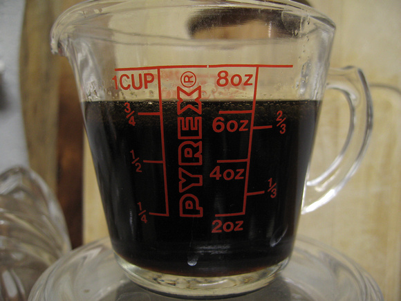

My fluid was like dark coffee color(see pic)(normally should be clear) and it smelled terrible. My STR has 92k at present, so it looks like its been in there since it rolled out of the production plant. Jaguar may not give any guidance other than just saying the SuperCharger oil is "Sealed for Life" but General Motors gives guidance in their scheduled maintenance - "check supercharger oil level every 25k miles or 3 years, whichever comes first". AFter putting all the **** back together I started her up and knock on wood, I heard her scream like never before , honestly I heard the smooth rich loud whine more than before on WOT; music to my ears
