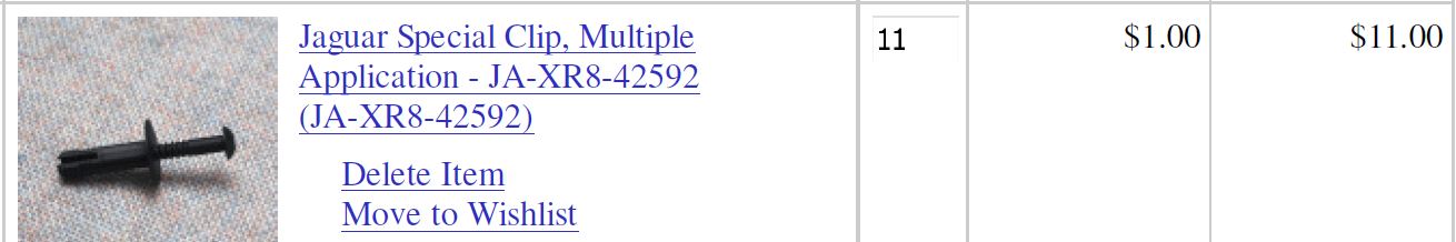

No those are not right. You need this one. They are unique and you won't find them at a parts store either. I can't get them off without cutting them. So they must be replaced every time the sill cover is removed.
XR842592-Expensive from Jaguar but are on EBay sometimes too. So look around.
You can see I found them for a $1 each.
Just a suggestion but as you know it takes 10 per car if doing both sides. Note I ordered 11 just in case I put one in and need to take it out for some reason. Just a little insurance at $1 each!
Sorry I forget but I got mine from Engel Imports/Terry's Jag-800-851-9438
And yet they fit perfectly and are exact the same that came out.
Might be a model year thingie perhaps >
XR842592 - Year Fitted 2004.5 - 2008

XR842592 are about 70p each in the UK. Now that I've seen it, it's fairly generic in design.

I got some from the nearest Jaguar dealer, 300 miles away. They have new clips to hold the door sill cover now. The clips are less than a dollar apiece, luckily they also mailed them to me for the basic postage cost too. They go on very easy, but don't hold the piece on super tight, at least it holds the trim piece on securely though. Most hardware stores have generic plastic retainers, no cheaper, but no mail order is needed either.
