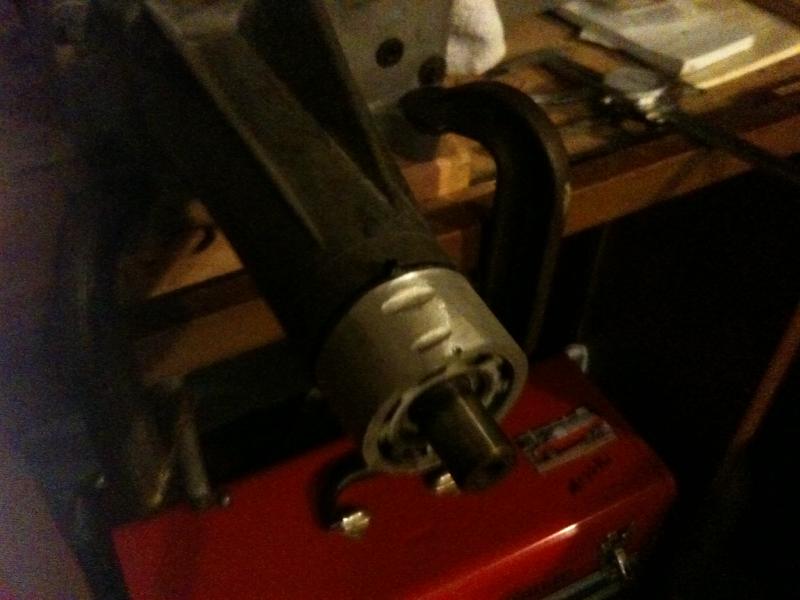

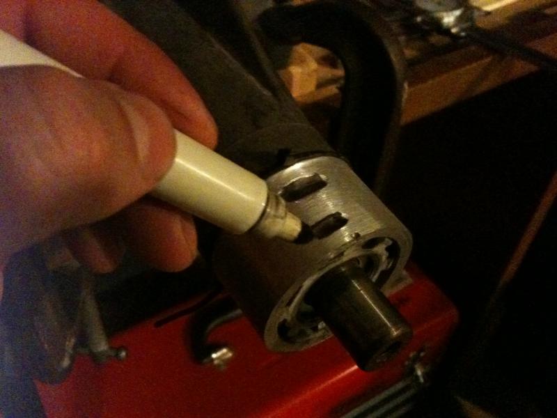

Default SC removal for coolant leak repair (preventive repair) and 2.6 pulley installation
I put this job off as I knew it would be difficult from reading this and other threads.
I began the project 7 days ago and it has taken 20+ hours just to remove everything. I also removed the recently replaced water pump again since it had a small leak from using an aftermarket gasket last year. Word to the wise --- use Jaguar gaskets!!!
New parts and gaskets were purchased from Manhattan Jaguar in Bethesda, MD. The parts guys were nice but did not seem to know a lot about this major repair. I had them go back and talk to the techs a couple times to make sure I purchased all the items need.
Last night, I milled down the SC snout to install a 2.6" pulley (2.5-3 lb.) which took 5+ hours to do.
I am now heading out to the garage to begin putting it all back together.
FYI, the coolant hose that runs at the bottom of all these parts seems to be as good as new. This is only a guess but it would have likely lasted a very long time and may not have ever blown.?.?.?
2005 Jag STR with 67,500 miles:
Engine bay with parts removed
Supercharger removal/coolant leak repair-img_2325.jpg
Round file and calipers to determine proper depth for new pulley clearance
Supercharger removal/coolant leak repair-img_2328.jpg
Mark depth and once black mark is gone stop removing material
1) Belt Sander = Done in four positions (noon, 3, 6, 9 o'clock)
2) Hand File = Done in four positions (1:30, 4:30, 7:30, 10:30 o'clock)
3) Sand Paper = Dummy Pulley from WhiteXKR
Supercharger removal/coolant leak repair-img_2330.jpg
Ready for 2.6" pulley installation
Supercharger removal/coolant leak repair-img_2340.jpg
I will post my own thread with details as I have time.
This is the most difficult and time consuming project I have done on any vehicle and I still need to put it all back together.
