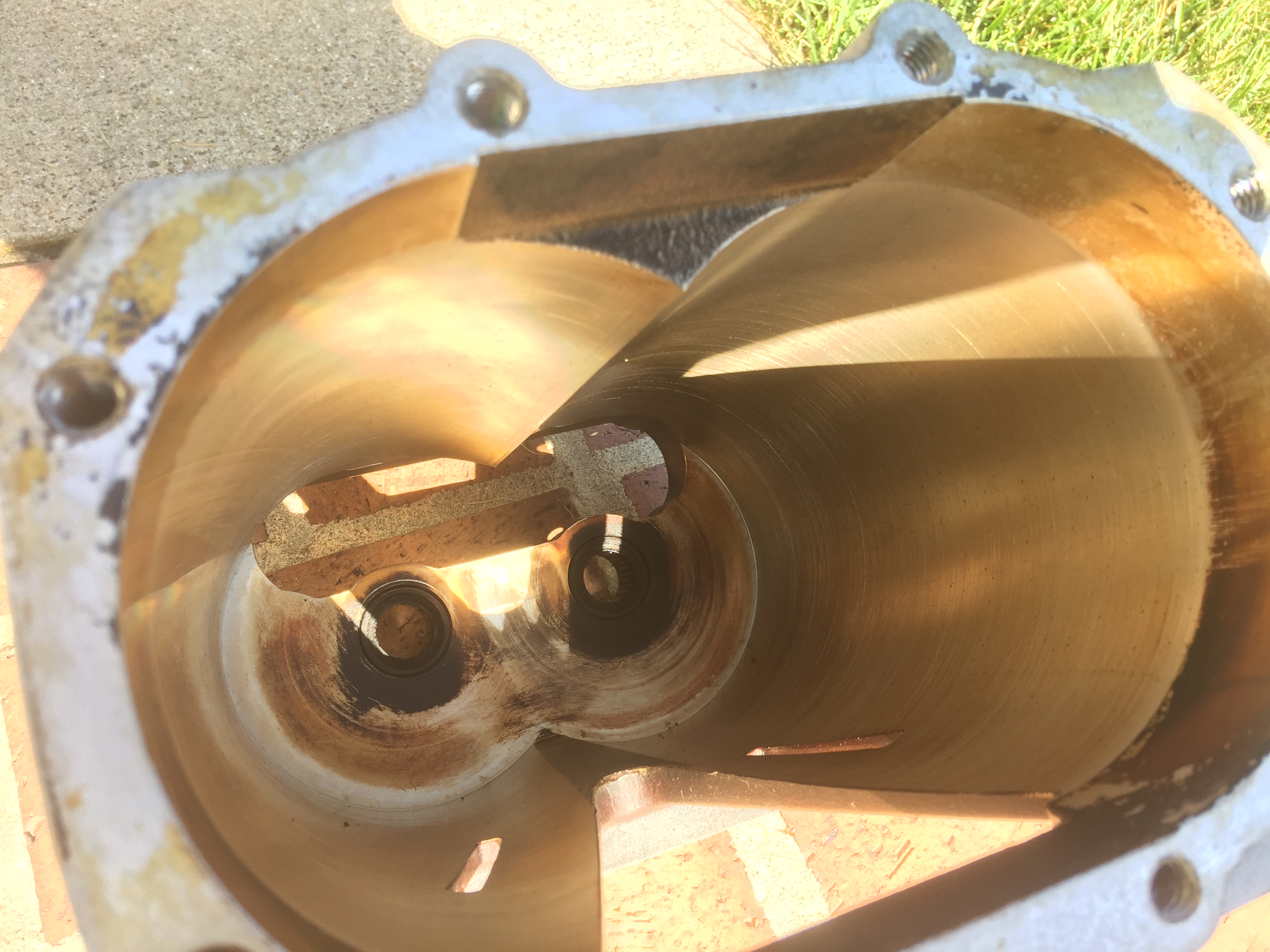

Does anyone have tips at replacing the rear needle bearings? I have an 05 4.2 and have the protruding bearing that has the cover with the little hole in the middle. Thanks, Dan

Those covers pop off. I used a press to push the old ones out and new ones in. Of course that required full removal of the sc.
I think I used a socket and 1/2" extension to reach through the case, since they can't be pressed in from the back. They come pre-lubed.

Thanks that helps! I took my time an got the supercharger out easy enough and took it apart last week. My real concern is how to get those bearings out, If I understand correctly they must be pushed from the back into the supercharger housing. Then the new bearings must be pressed into the housing from the inside of the supercharge.
Is this correct?
Back of supercharger
Inside of supercharger
Attached Thumbnails Supercharger repair - help please-img_5964.jpg   Supercharger repair - help please-img_5967.jpg

Yes that's correct. I did it with a friend's help and a press. If you have a local machine shop they would probably do it pretty cheap and make sure the bearings dont get damaged.
Is this correct?
