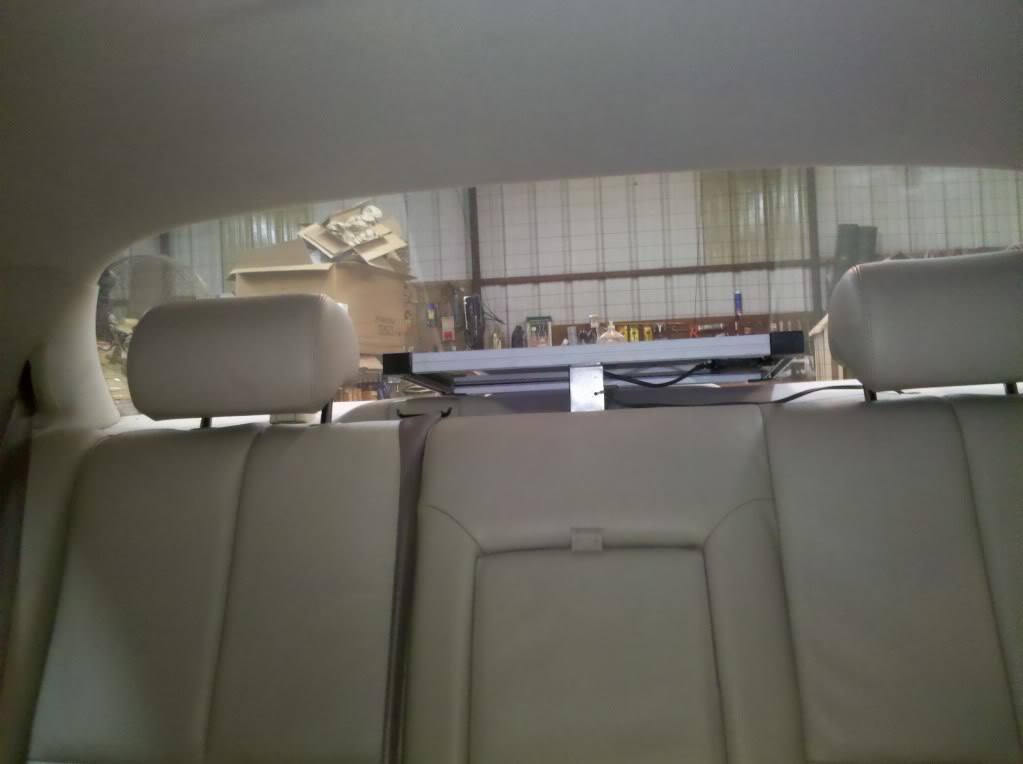

Quick update
Stopped off at Harbor Freight on the way home from work last week and picked up a "bending break" for $39.95 with an advertised capacity of 16 ga steel. Did a quick-bend on a bit of scrap 1/8" X 2" W Al stock left over from my bracket fab and confirmed it was up to the task. Before compromising the $12.55 bar-stock (1/8" X 2" X 48") I picked up at the bldg supply (with visions of returning it still dancing in my head) I did a quick-fit with a bit of scrap 1/16" thick Al that was long enough to make another bracket. My suspicions that it would be too flimsy to meet the task were confirmed once I completed it...but measuring/forming/drilling etc. was good experience before I take a stab at the thicker medium:
Before:
side-by-side:
After:
Well, now she can see what she's backing into......
It would be "functional" as-is, but I think it would rattle against the back glass. I'll attempt to rework the original bracket. If unsuccessful, I'll delve into the $12 stock. I notched the mounting hole which I believe will give me clearance for the wiring sans pinching. Didn't feel like unrouting/rerouting it since I'm not yet to "final" on the mounting bracket.

Finally "went final" on the solar-collector mounting
I was able to re-work my original bracket into what I wanted, but may just have a 4' length of 1/8" X 2" Al bar stock added to my project supplies - took me so long to get 'round to fixing it I seem to have misplaced my reciept! The $40 Harbor Freight bending break was well-worth the investment. I effected the notch in the mounting hole as in the interim bracket, allowing the wiring to be co-located with the mounting bolt, which also facilitated re-installation of the left-side child seat upper anchor and trim. Electrically - Everything seems to work fine - as one would expect with a new battery! I reckon the true test will be next fall/late winter or beyond when the battery is a couple of years old and she is still making tiny, cross-campus trips after dark.
