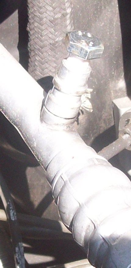

I repaired that problem, paid 60 cents for the bolt. That was not Jaguar
