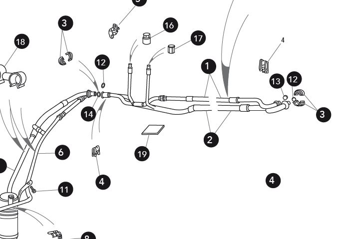

Number 17 in te diagram iss the low pressure port. If the fitting is too large for the charging hose then you are probably trying to attach it to the High pressure port.
