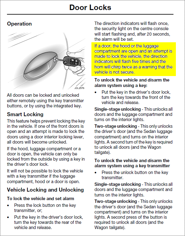

It sounds like the FOB is programmed properly. The car is sensing a door, the hood or the trunk being open.
Lol it was actually the key door on the ignition. I found another thread from 2011 with a similar situation and found the ignition may be the problem. Got it unstuck and it works fine now so on to the next problem. Thanks for the help guys.
