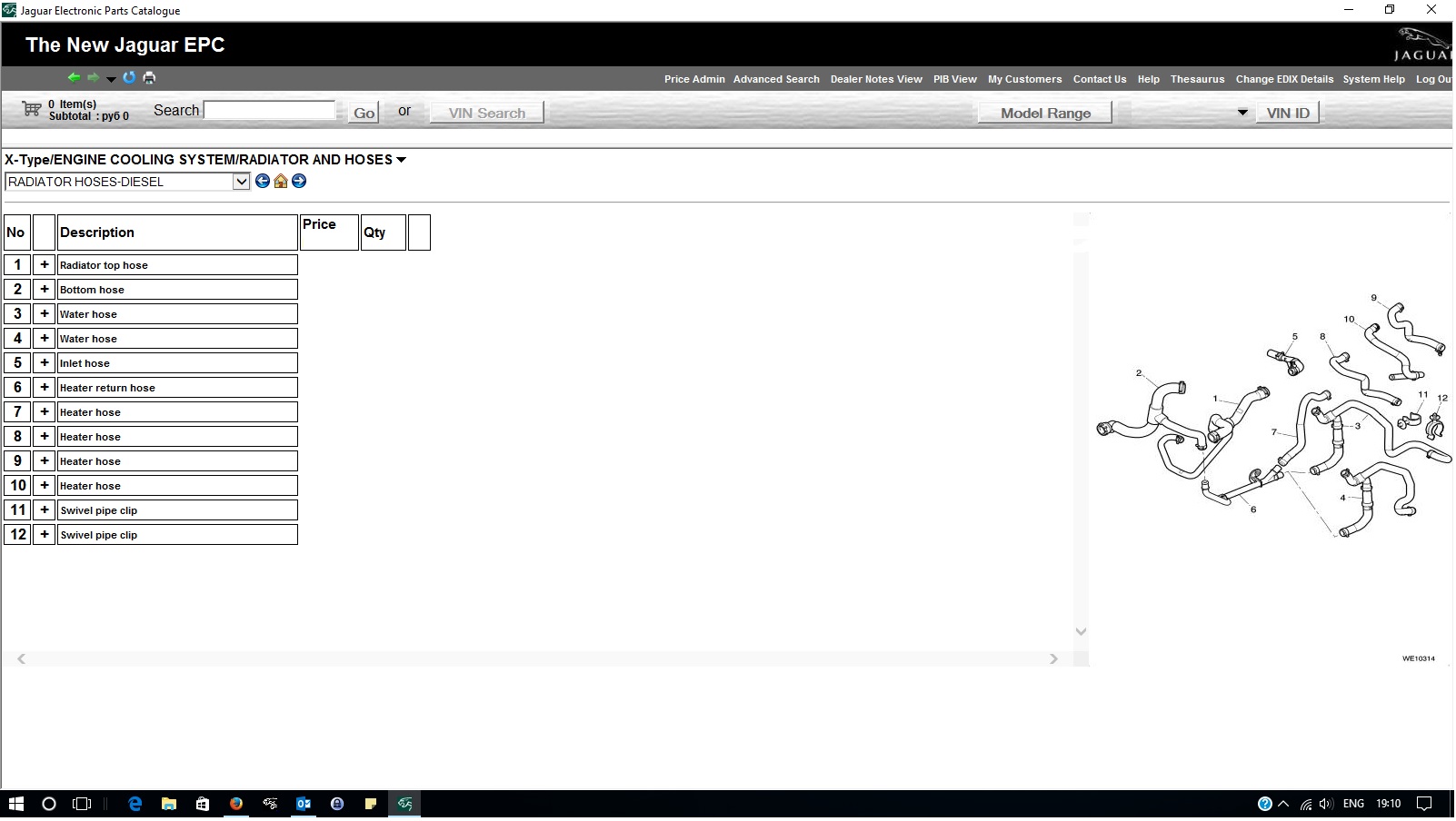

Hello. Does anybody have a diagram of the coolant system. I have a leak in a hose just below the starter motor. The hose finishes just above the oil filter. Can't find the name of the part to order. Thank you.

Here's the relevant extract from JEPC (Jaguar Electronic parts catalogue) for the X-Type (diesel) cooling system hoses:
If you can identify the hose, I can lookup the part number.

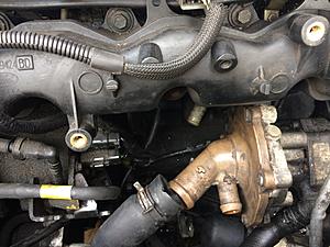

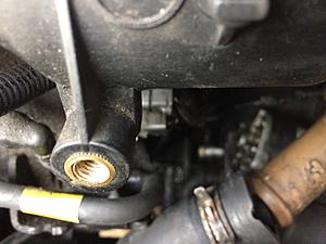

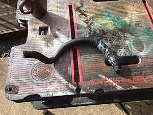

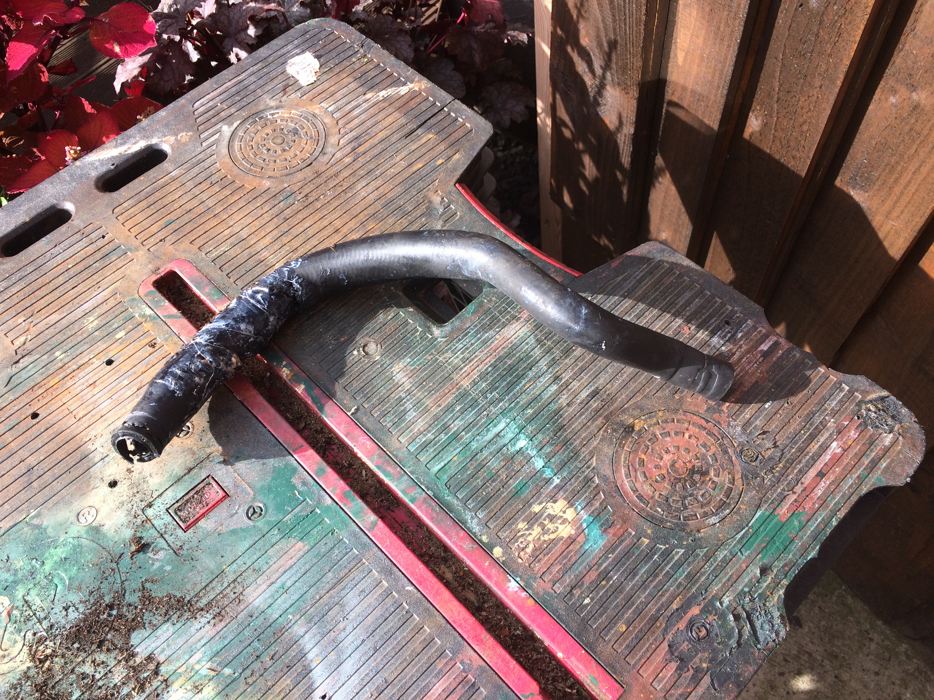

Thank you for sending the diagrams. I have taken the pipe off again. Can anybody identify it from the pictures?. It is only about a foot long with a twist in it. It comes starts just above the starter motor and finishes below. As you can tell I am a novice repair man

P.s. The third image...It connects to the small pipe almost in the middle of the image. Not the larger one in the bottom right section

I'm relatively sure it is the throttle body coolant hose
