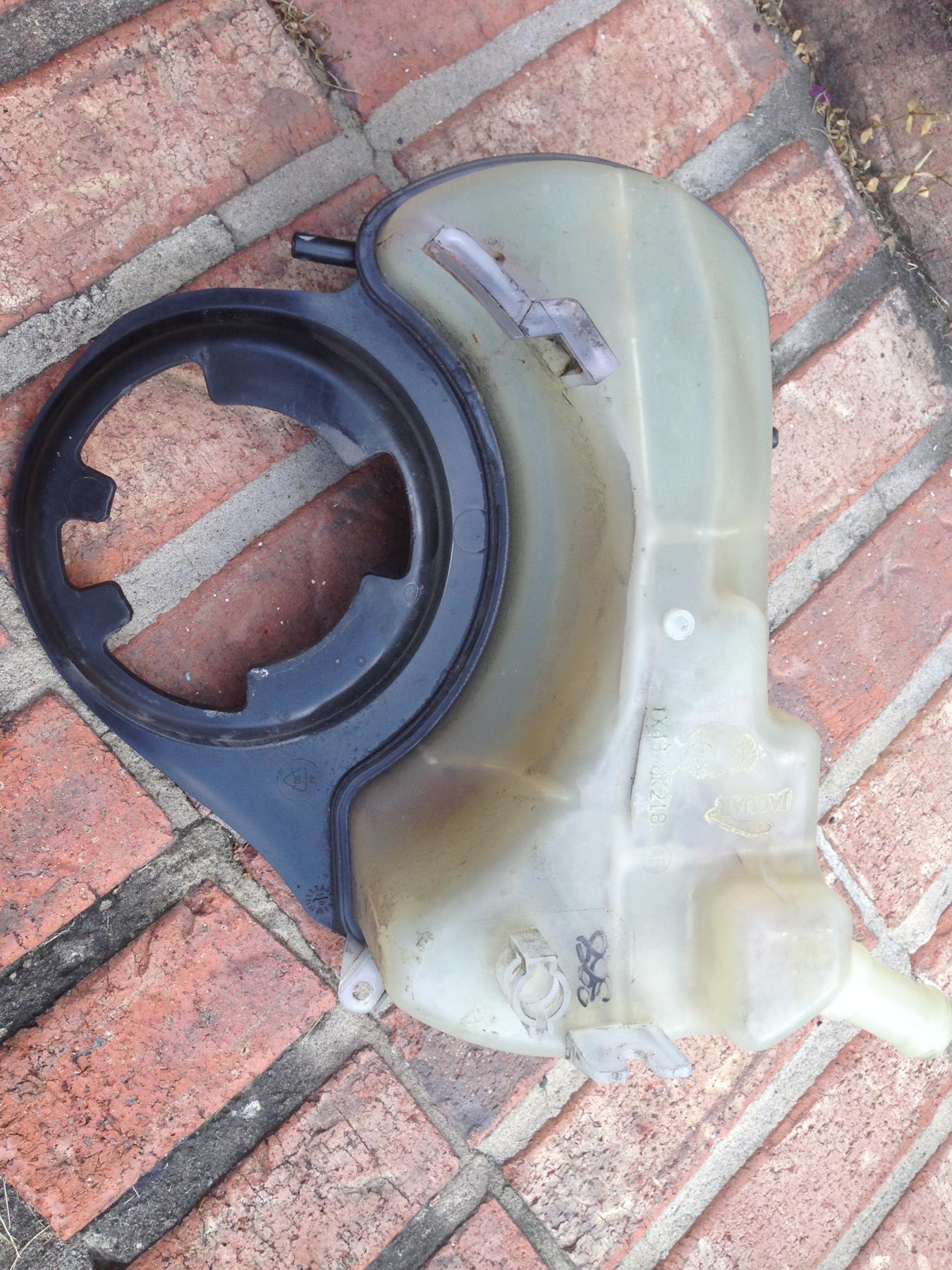

Hi everyone,
Well, after nearly 60,000 miles of trouble free driving, my 2005 X-Type 3.0 has developed its first real issue. I'm certain the nipple on the coolant expansion tank is cracked. Does anyone have advice on the best place to buy a replacement reservoir?
For the last year or so, I've been slowly losing coolant, but couldn't figure out where the source of the leak was. By slowly, I mean the level in the expansion tank would drop from the max line to the min line every two months or so. Not being able to find the source and because the loss of coolant was so gradual, I just replenished the tank and was good for another couple of months. Then today, I drove the car to work. As I parked and turned off the engine, I could smell a faint whiff of coolant and noticed that the radiator fan was still running on high even with the engine off and the engine temperature gauge showing normal...Uh-oh. I popped the hood and saw that the expansion tank was completely empty, with coolant residue splashed all over that area. Crap!
At lunch, I used my wife's car to go get more coolant and distilled water. I left my car parked until the evening to let the system cool down enough for me to check the cap and open the reservoir without getting scalded. First I verified that the cap was on really snug - it was. WTH? I refilled the reservoir to max - it took about 2/3 of a gallon of coolant mix to do it. No obvious signs of leaking and the engine sounded fine, so I drove it straight home. Thankfully, the car was driving normally and the temperature was normal.
When I parked at home and opened the hood with the engine still running, I saw a steady drip of coolant coming from the expansion tank nipple. There was also evidence of an upward spray of fresh coolant which splashed on the hoses, underside of the hood and windshield trim, and the reservoir level was also back below the min mark after 12 miles of driving. Ok, well this is different and now we're gettin' somewhere. I turned off the engine and looked closely at the nipple where the drip seemed to be originating from. It was drooping slightly and I suspected that there was a hairline crack right where the nipple met the tank. To verify, I pressed on the nipple lightly and heard steam escaping from the coolant reservoir. Loss of pressure, and now obvious that the nipple has a hairline crack in it.
I'm attaching photos for others for future reference to aid in diagnosing this problem since it's such a common failure point on the X-Type. For those of you who have been through this, any recommendations on the best place to source a new expansion tank? I don't want to pay the extortion rates charged by Jaguar dealers, and am hoping that over the years, someone's found a less expensive replacement source. Please let me know if you have advice on where to shop for a replacement tank. Thanks!
Attached Thumbnails Cracked coolant tank nipple Best place to buy a new coolant reservoir? RESOLVED-tankcrack01.jpg   Cracked coolant tank nipple Best place to buy a new coolant reservoir? RESOLVED-tankcrack2.jpg

You might want to remove the tank and inspect it for cracks before re-using it. I had planned to try a similar repair using a plastic welding machine but found these cracks on the underside and decided to purchase a new tank instead.
Attached Thumbnails Cracked coolant tank nipple Best place to buy a new coolant reservoir? RESOLVED-coolant-tank.jpg

I recently purchased a coolant reservoir on eBay from ImportPartsDirect for $38.45 including S&H. The top two nipples have metal sleeve reinforments inside. I can't attest to how long it will last, since I just installed it. But the seller's eBay feedback rounds to 100% positive on over 23,000 sales, so they must be doing something right.
reyesl is correct about stress cracks in the bottom of the reservoir. Attached are pictures of the old coolant tank from my 2002 X-Type with ~125 Kmiles. The cracks are the dark lines in otherwise white plastic, and they allowed coolant to slowly leak whenever the system was hot and pressurized.
