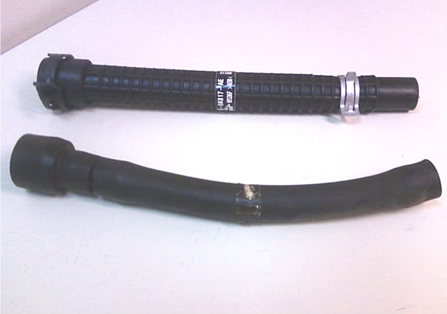

Hi I recently got a Jag X-type and from reading this thread I replaced the PVC pipe. I got one from the dealer in Tucson for $16. Two mins to install. Good call! The OG pipe is just a fiber-reinforced rubber tube, the new one is a black PVC molded part with clamps! Here's a pic of the two.

hi i also had this problem and after looking at Buckmr2 photo found a split that ran almost the entire length of this hose, don't know if it is rectified but the cruise control unavailable and engine management light went off immediately, my question is my car has been showing P0430 and P0420 emission control problems, could the split in this pipe also been the reason for these engine codes ?

Those 2 codes will definately be related to the split pipe (had them on mine when the hose was split).The chances of 2 different sensors on different engine banks going at the same time are minimal.
Unmetered air gets into the system through the split and causes incorrect readings from the 2 lambda sensors upstream of the cats.
Im sure once you replace the pipe (or tape it temporarily) within a few cold-hot drive cycles the MIL will extinguish.

I lifted the bonnet with the engine running and heard a hissing sound - which I located as being right near the PCV hose. I turned off the engine and removed the plastic engine cover - checked the hose and it was intact.
I realised that the end of the hose that runs into the cast metal area at the bulkhead end (?manifold / injectors) had pulled away from the metal flange which had a rubber 'collar' around it, so was not giving a good seal (mine was the hose that had no jubilee clip at this end of the hose, and was just a push-fit onto the metal.
I resecured this, by stretching the end of the hose back over the rubber 'collar' and pushed it all back over the metal pipe/flange bit sticking out from the cast metal (sorry, my mechanical terminology isn't great).
