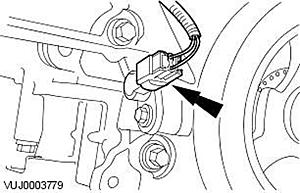

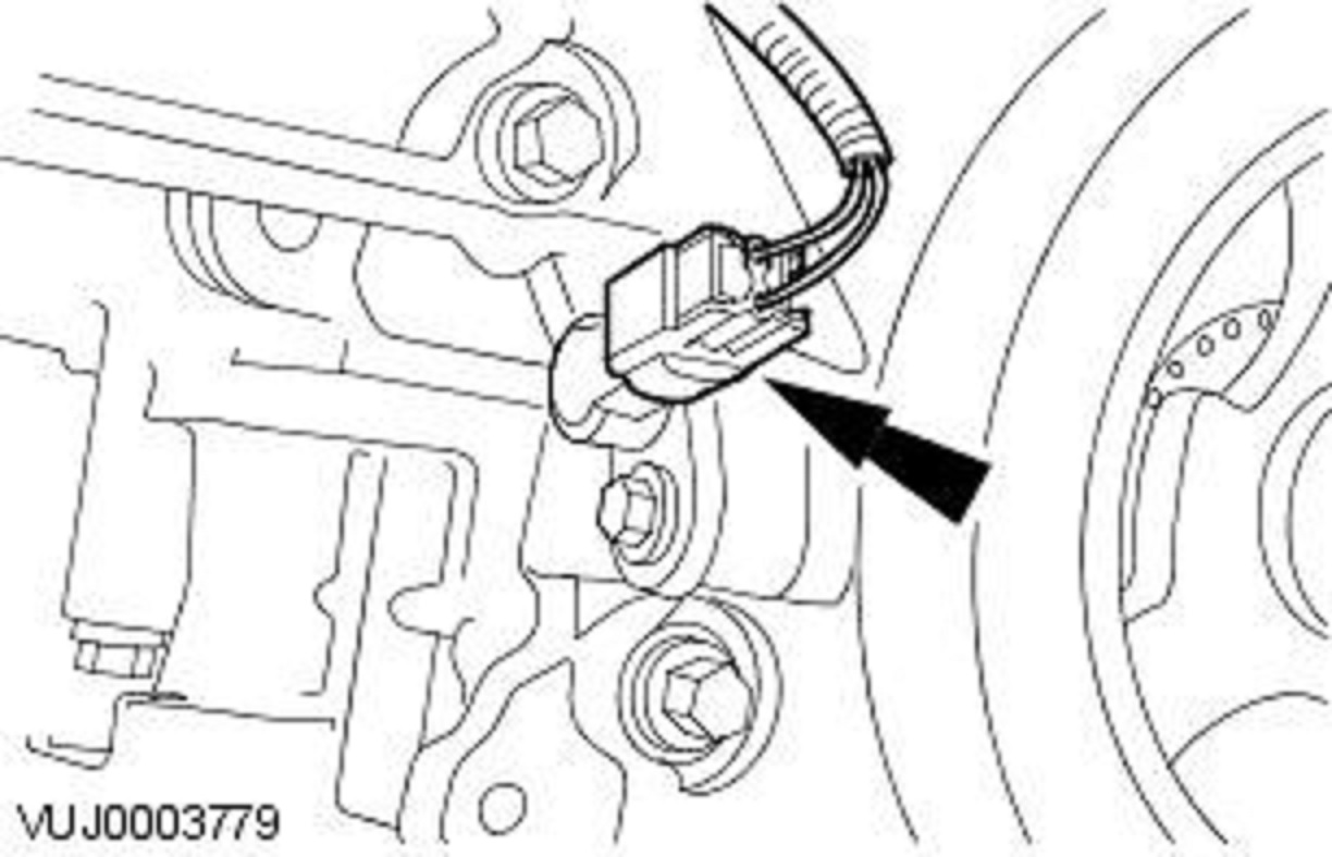

Hi, Sorry to sound dim, I'm normally pretty good around an engine but I have been looking for the crankshaft sensor for over an hour with a torch but I can't find it. Can anyone point me towards a diagram or a photo please ?
Old 02-18-2018, 06:58 AM
PanamaJag's Avatar
Join Date: Jul 2014
Location: Fl
Posts: 247
Received 54 Likes on 40 Posts
Looked at the shop manual for gas engines and shows the Crankshaft Position Sensor to be near the main flywheel.
Do not have a manual for diesels, but probably in a similar location...

Harry,
On the left hand side of the engine, follow the egr pipe back that goes to a flange of the egr cooler, directly under this flange you will see the crank sensor plug on the gearbox/clutch bell housing.
Paul.

Old 02-18-2018, 08:17 AM
avern1's Avatar
Join Date: May 2012
Location: Winchester, CA
Posts: 3,290
Received 1,319 Likes on 1,004 Posts
Attached is the part blow up from the SNG Barratt cataolg so you can get a visual of what you are searching for. It doesn't appear from the blow up to be mounted on the rear of the engine.

Old 02-18-2018, 08:57 AM
Man on the hill's Avatar
Join Date: May 2017
Location: North Wales
Posts: 179
Received 19 Likes on 19 Posts
The catalogue does not show the relative position of the crank sensor.
When looking at the clutch bell housing to engine block mating bolts, the sensor is at approx 1 o' clock, when looking from the left hand side wing, and it is directly under the egr cooler flange.
Paul.
