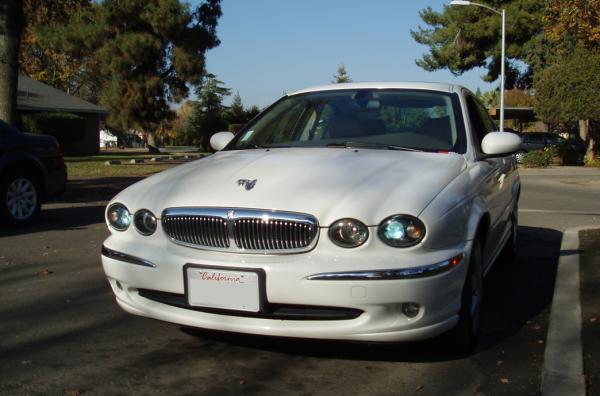

I went to take a picture of my new lights and I turn them on and only the drivers side was on! So I disconnect the ballast and reconnect it and fiddle with the wires and it would just turn on for a split second when I plugged it in then turn off. So I was thinking there was a short in the wiring or it was a bad ballast or something. So I switch the passengers' side with the drivers' side ballast and it works fine. So I plug the other ballast into the drivers' side and it works too!? So now they are working again, but I didn't do anything other than that. I thought it might be a fuse at first or something. This is just frustrating. One day and already a headlight is out. I'm keeping my fingers crossed I don't have any other issues with it. This is exactly why you shouldn't buy the least expensive HID kit you can find from China. If the ballast turns out to be on the fritz, I am going to try to get a replacement or upgrade to a better kit. They were supposed to be AC but when I got them they had no mention of being AC. They almost look like the Xentec's so I'm guessing they are DC even though I specifically asked them to send the AC kit. I was just hoping they'd work and I'd save a little money but I can already see why it would've been wise to spend a little more on a good kit. Any ideas? Now both ballasts appear to be working. Will post the results after a while.
![](https://www.jaguarforums.com/forum/attachments/x-type-x400-14/64312-hid-install-so-annoying-04xtype04-141812-albums-garage-type-x-8389-picture-21982.jpg?dateline=1385849879)
