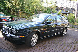

This is a comparison of the original amber and the clear units - much better! Oh...and the change of wheels helps a bit too! Since these photos were taken the amber units in the bumper have also been changed to clear - it completely cleans up the side view - and in both units I use amber bulbs.
This is a Canadian-market car.

I agree. You made some nice improvements this way. My side repeaters already aren't amber. They're greyish but the new ones are more like clear glass with chrome behind it. I'll try to also post before and after pics when they arrive, which should be somewhere this week. This is how.it looks now on the side without damage:
I'll try and make clearer pictures when I put the new ones on.
