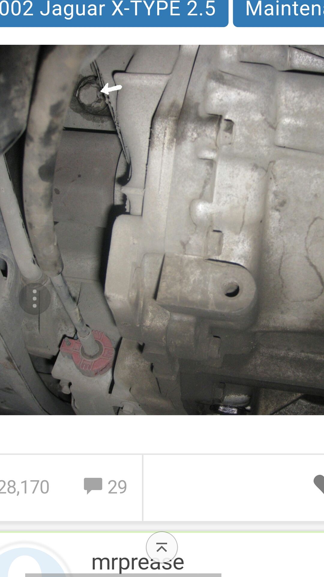

Hey Dell...I just noticed something that needs clearing up...when you posted this pic I was under the assumption where you marked "DRAIN PLUG" was the tranny drain plug (which I am sure is 100% correct) but then you labeled the other one "NOT THIS" and I assumed from my question the "NOT THIS" bolt was the dreaded reverse band bold?
However I was reading through another thread of yours and the one you labeled "NOT THIS" in this thread, you labeled as the "transmission fluid level check" in another thread. I will attach your own photo you used.
So my question is: What is it? The reverse bolt or the fluid level check bolt?

Fluid check valve, refer above in thread where the reverse bolt is, described and pictures. Here's why I think it gets mistaken for level plug. Again this is just MY thought process. If you wanted to check fluid level, would it not sorta make sense it would be the highest (or higher) removable plug? Bingo! The reverse plug is higher up. Look at the dissected transmission picture where he's replacing the bolt to hold the reverse band.

Note the term fluid check TUBE. So again my thinking. The internals of the transmission have a TUBE that is at the correct height for full transmission. When it hits that height internally it flows into the pipe and drops down to the check outlet. THUS why the Jaguar procedure is so involved with correct temperature, etc. Because filling with cold fluid until it ran out, once heated and expanded in a closed (sealed) system would not be great. There again counter to so called normal thinking of check level plug would be the highest removable one (but IS NOT).

Ok Dell....I finally think I have it down now. This gets really confusing to those of us learning to either DIY or pass the information onto the mechanic. Anyhow I saw the other picture you posted now (I must have skipped by it) and that is a pic of the automatic tranny, right? And if my eyes are seeing correctly the hose that passes by the reverse band bold leads "down" to the level check plug so they both are in the same general area but as you said, the logic is reversed - the higher bolt one would think is a level check but it is actually the lower one with the tube and that red housing by it.
