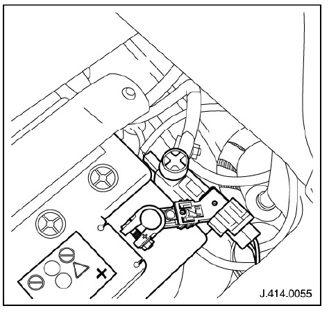

A Transit Relay is fitted to the battery at the factory. This allows the vehicle to be driven when necessary but isolates the battery from the vehicle during transit and storage preventing the battery becoming discharged.
The Transit Relay is disconnected and discarded by the Dealer at PDI. For this reason I don't have a photo but here's a drawing:
The battery terminal is connected and the lead you found tucked away out of site until discovered years later by approximately one in ten Jaguar owners.
