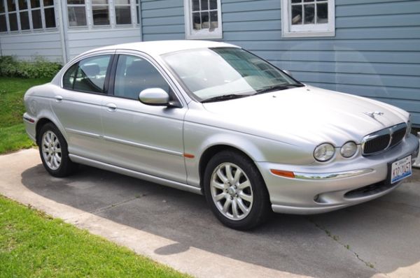

Hello, I’m brand new to Jaguar ownership having just bought a 2003 X-type project with 109K miles, a manual transmission, and a bad 2.5L engine that I plan on swapping out for a used one. I’ve search the forum and downloaded and read the JTIS service manual, but I still have some questions regarding the purchasing of a used engine that I need some expert advice on:
I’ve seen posts that say you need to buy the ECU and ignition key with the used engine, but I wonder why I can’t just hook up the new engine to the existing wire harness. At worst I might need to swap some sensors and transfer some of the ancillaries.
Assuming the used engine comes with its flywheel, I was thinking of trying to get an engine from a manual tranny car to make the swap a little easier, but are there other differences I need to know about if I get an auto tranny engine, such as does the same starter fit both (believe answer is yes based on part catalogs).
Should I stick to the same 2003 year due to changes in sensors or other equipment or what year range do I need to stay within – 2002 to 2005?
I am going to try and find an engine with less than75K miles, but beside standard gaskets, what all items are known problem areas on these engines that would need addressed before installing the used engine?
