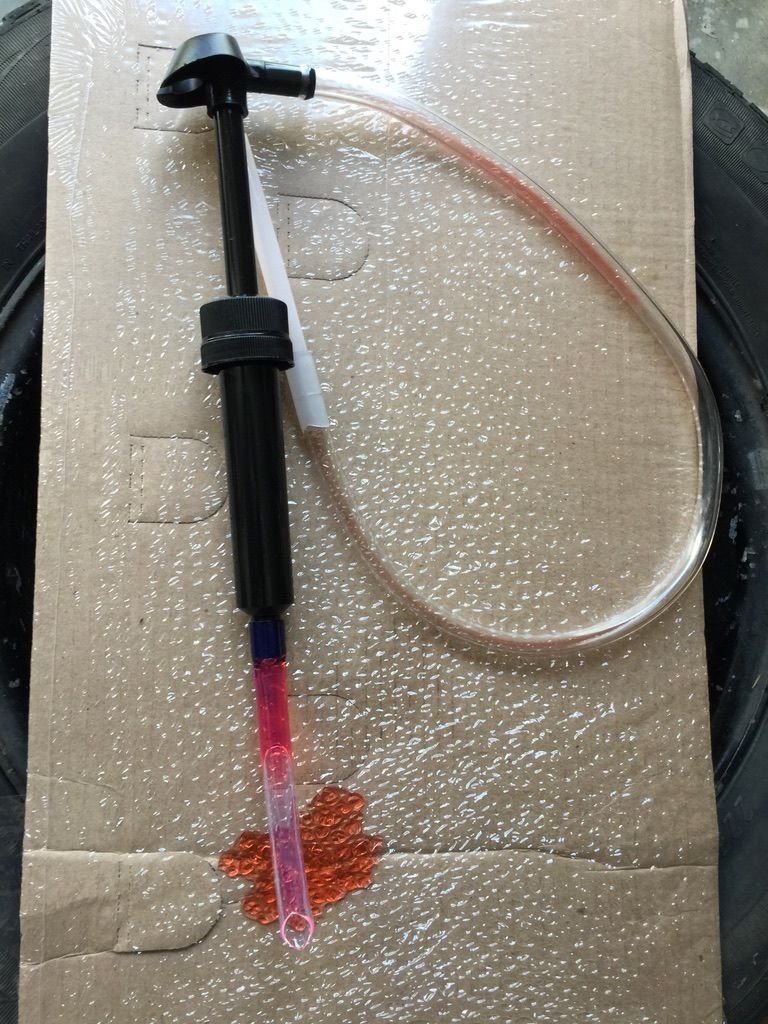

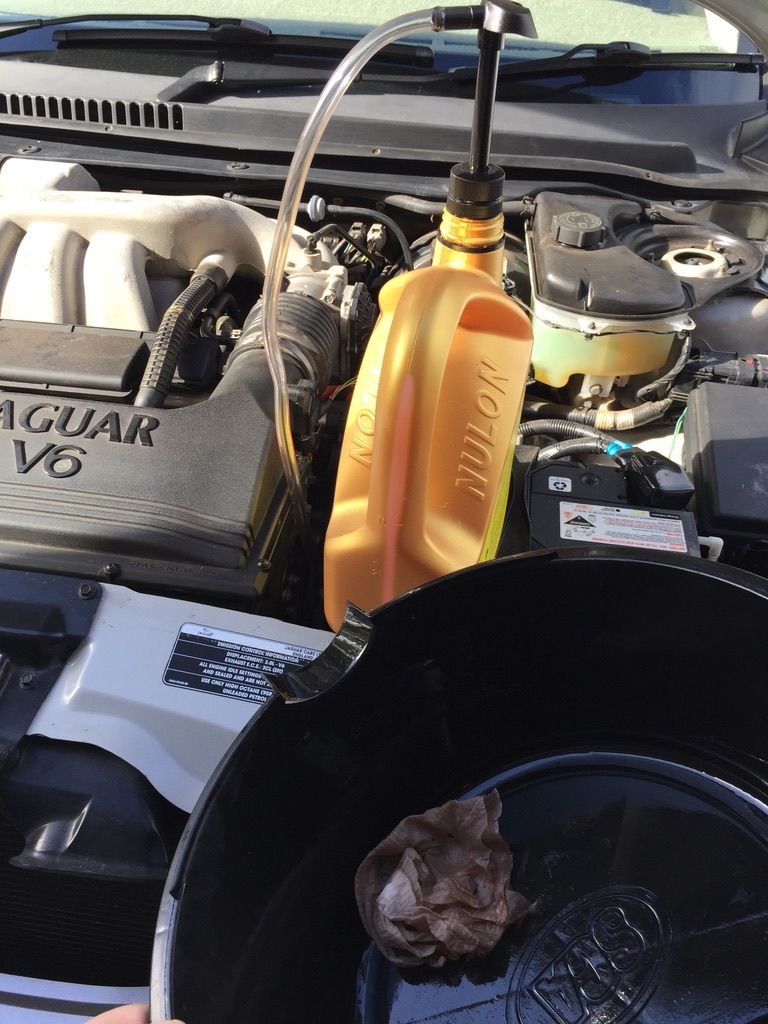

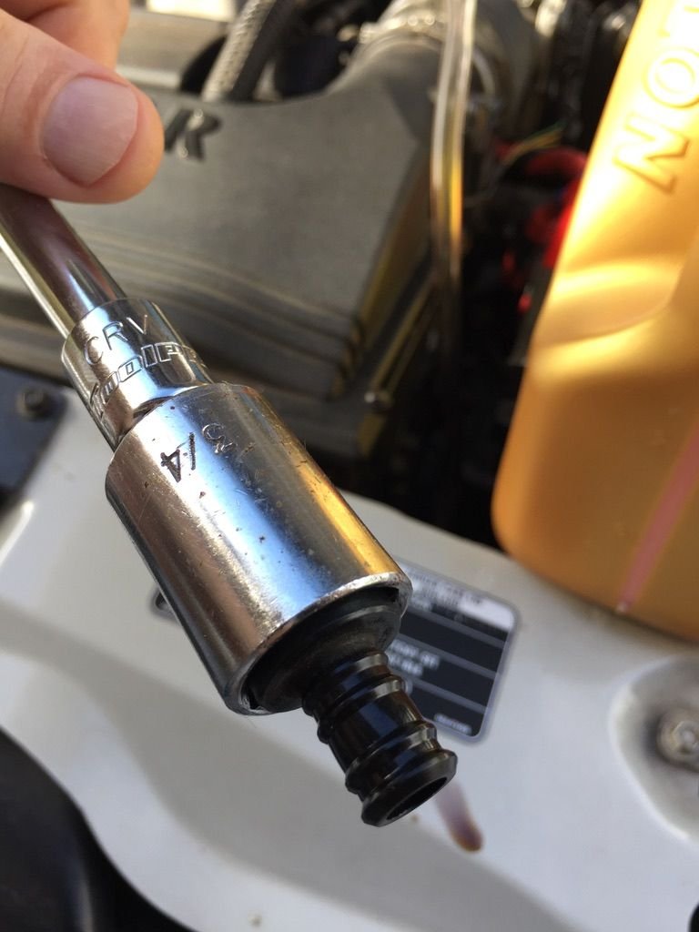

OK, I had the opportunity to drive it today for a few hours. Shifts are positive yet smooth. The car keeps getting quieter as I change out these old fluids. I bought 3 gallons of ATF to do this and measured off a half quart from each one, now in one of the ATF gallon containers. So I have a quart and a half. If I buy 2 quarts, I can do it again. And I might after driving it a while.
Maybe I just lucked out that I can reach my little rubber fill plug from under the hood and it's a straight shot down and not half hidden under the battery box. And I can shimmy my hand in there to pull it.
But, seriously, this is so easy and the results so immediate, I think anyone that gets one of these cars and doesn't KNOW if it's been changed, should do it. I drove mine up onto 3 stacked 2x12s...each one shorter than the one below it... screwed together.. and had plenty of room to get under there and get the plug out and have a pan under it.
Oh... and the turkey roasting pans from the dollar store worked perfectly.
If you haven't done this. Do it.
