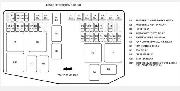

If you have had gauges on it and it is charged with no leaks. I would look at the system low pressure switch. You said the compressor doesn't engage. It could be bad fuse or relay to the compressor clutch. The low pressure switch is located behind the wheel arch cover on the right side of the vehicle.
First check fuse #23 in the engine compartment fuse box. That fuse is for the AC clutch. The swap out relay R5 windshield washers for Relay 6 AC compressor.
