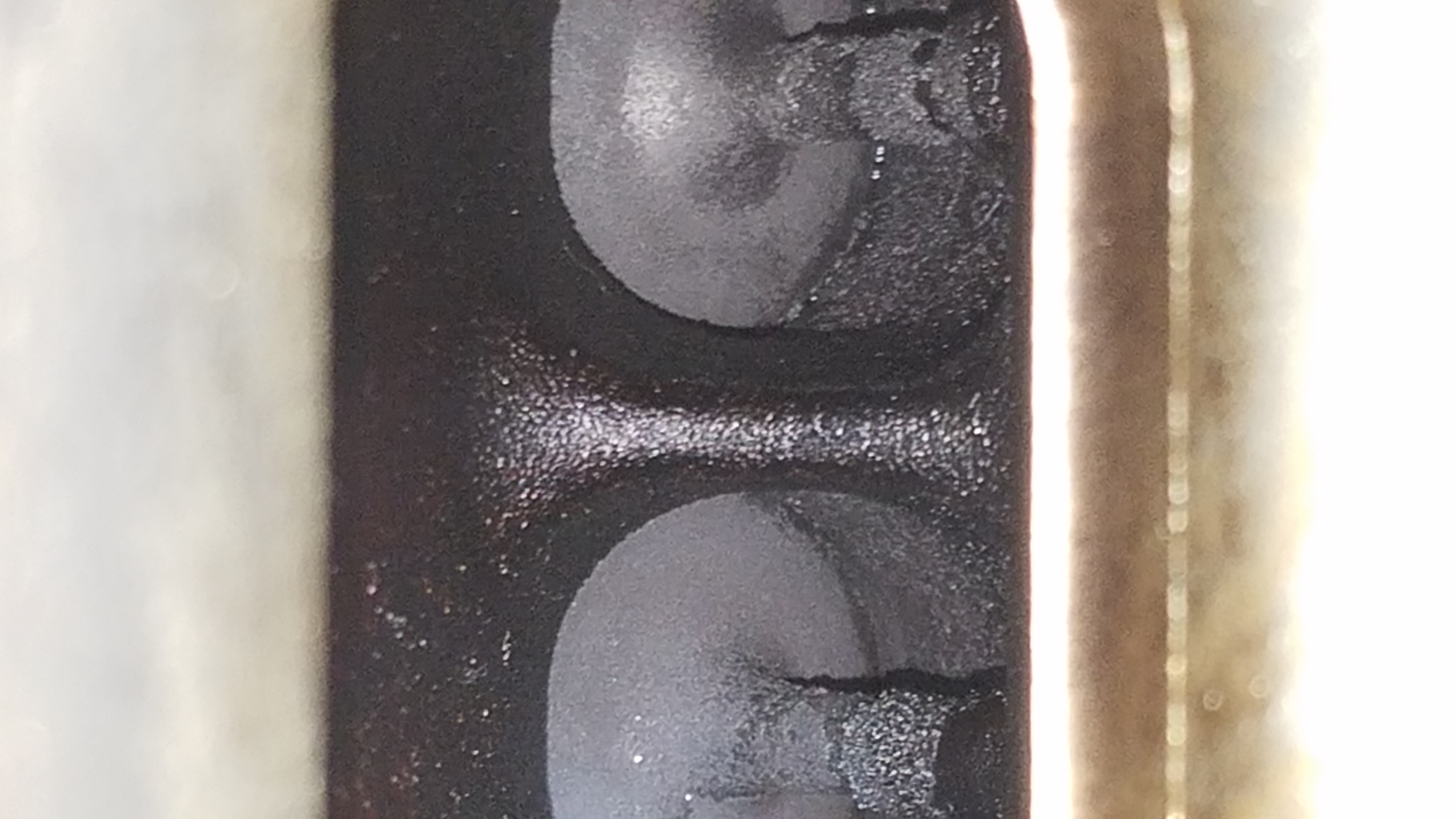

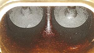

Can't comment on how the other forums members fared in their cleaning efforts, but I had my intake and S/C off recently and my valves were crusty (at 45,000). I tried the intake cleaner sprays and that worked the thin greasy film off, but the hardened on gunk was impossible to get out. I am having the intake valves shell blasted to get them cleaned up. Keeping them clean is the other issue as I also think that any spray into the throttle body will not help since it has to travel through so many other components...plus you will eventually delaminate the impeller coating. A direct port system is the only viable solution, but I will have to get creative and really study the available space. The curious thing is the different deposit patterns. Four of the intake walls were blackened with sliver colored valves...two were clean intake bodies and blacked valves.
deposits all over...
same bank....different deposit pattern...why??
