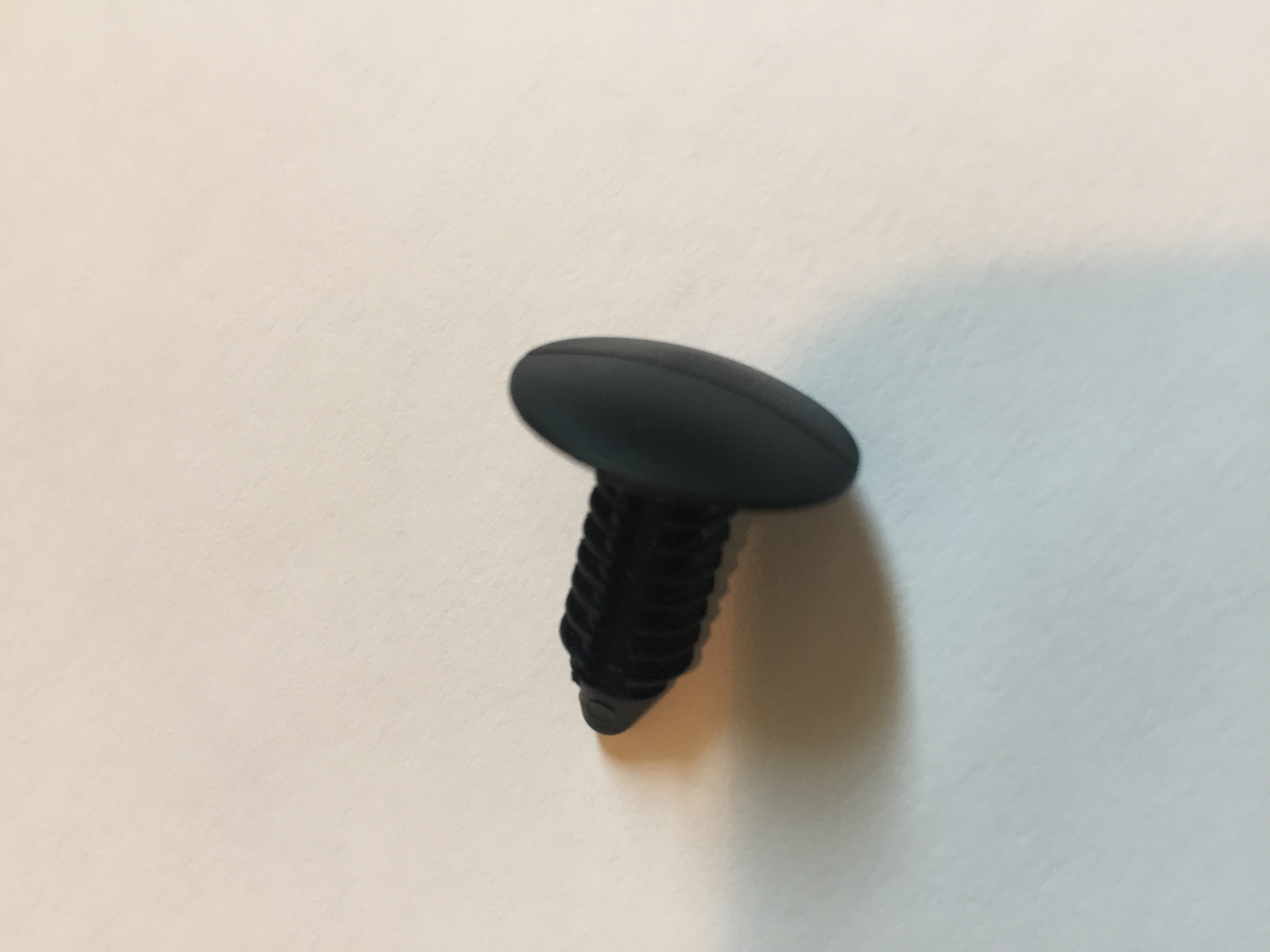

I have a 2009 XF and I'm hearing a rattling plastic sound coming from above the back seats. Opened up both rear seats to expose the sound. It's not the trunk, but I believe it's above the trunk in the console above the rear seats. It sounds like a plastic bubbling something rolling around. It's loud. Does anyone know what I can do to solve the problem, without taking it to a mechanic. I don't want to start tearing it apart without knowing what I'm doing. Is there a loose part, or does something have to be tweaked?

Smile Constant rattle in back
SUCCESS!!! I'll start by saying that I have a detective for mechanic.
After much back and forth, he put his mechanic in the trunk with the seat backs down. They found the problem. The little plastic round clips that connect the lining to under the rear top were broken. He replaced them, and VOILA. No more bubbly rattle. He also suggested that I put some acoustic foam in between the area, so that it muffles anything. We haven't done that yet, but plan to. It's incredible. I could cry tears of joy. The sound was making me absolutely batty!!!
