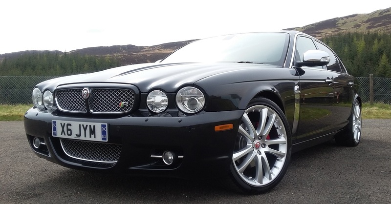

Hi there, just a quick note re plate fixings
It's not necessary to drill holes, use screws etc etc
see below my front plate on a curved front bumper of my XJ X358
For many years now on all my cars, I've used an alternative method, I hate the look of screws, even with coloured caps etc. They nearly always come through on part of the registration number and just look unsightly.
I use 3M double sided tape as do many others. Simply apply enough and then remove backing paper and stick in place, it'll be all good and stay there in place firmly until you decide to remove it.
I've removed damaged plates in the past and replaced and it's an easy process generally. Use a hairdryer or similar to soften the adhesive and or fishing line, then clean the area for a good as new look......no damage to the paint / bodywork, period.
It's a good clean look too
After all 3M products are often used to hold on badges and side mouldings etc, so a plate is no problem
Hope it helps

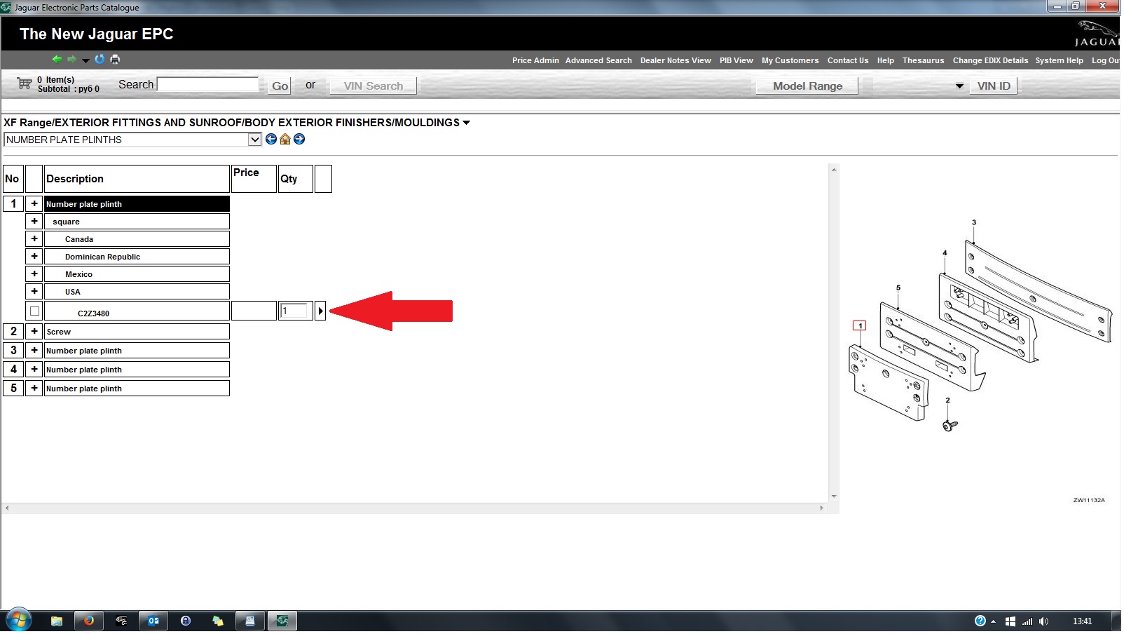

If you feel you have to fit one and want to go OE, Jaguar supply the appropriate size moulded plinth for all plate sizes. The US one is P/N C2Z3480.
In the UK these are usually finished in body colour to make them less obtrusive.
