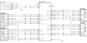

Ok, so I've attached wiring diagram for your vehicle - Climate Controlled Seats.
There are 2 fused in central junction box #26 and #28, both are 20a mini fuses. Pull them out and inspect. Make sure there is power to them.
Everything else with the seats work correct, all movements etc.....
Thanks for this I'll give it try on weekend.

Hi again guys and thanks for all this info.
The advice about fuses I think was correct.
There is a schematic posted which says 26 and 28 are my fuses, but I think something's strange.
Firstly I don't have rear vented seats than, in the owner's manual from the Jaguar website says fuses 25 and 27 are driver and passenger seat cooling/heating.
The schematic has different numbers.
I've just checked the fuse box and fuse 25 is 10A, fuse 26 is a 20 A (in the manual that's for trailer and my car is not provided with this) and 27 is missing.
If the manual is correct I just have to replace 25 and put a new one on 27 slot and hopefully it'll work.
I'm just a bit afraid not to put the wrong fuse in wrong place.
So in the end the questionis which one is okay, the manual or the schematic posted?
Thank you again
Thank you again
Don't trust the diagram in the Manual, it was wrong on both my XFS and XFR.
Instead go by the schematic on the underside of the fusebox cover.

Default no diagram
Hi,
There is no diagram on the back of the access pannel.
Only the fuses have numbers.
And, anyway the diagram does say what's for what.
I meant the electrical diagram posted earlier.
Is it 100% correct?
Thank you
