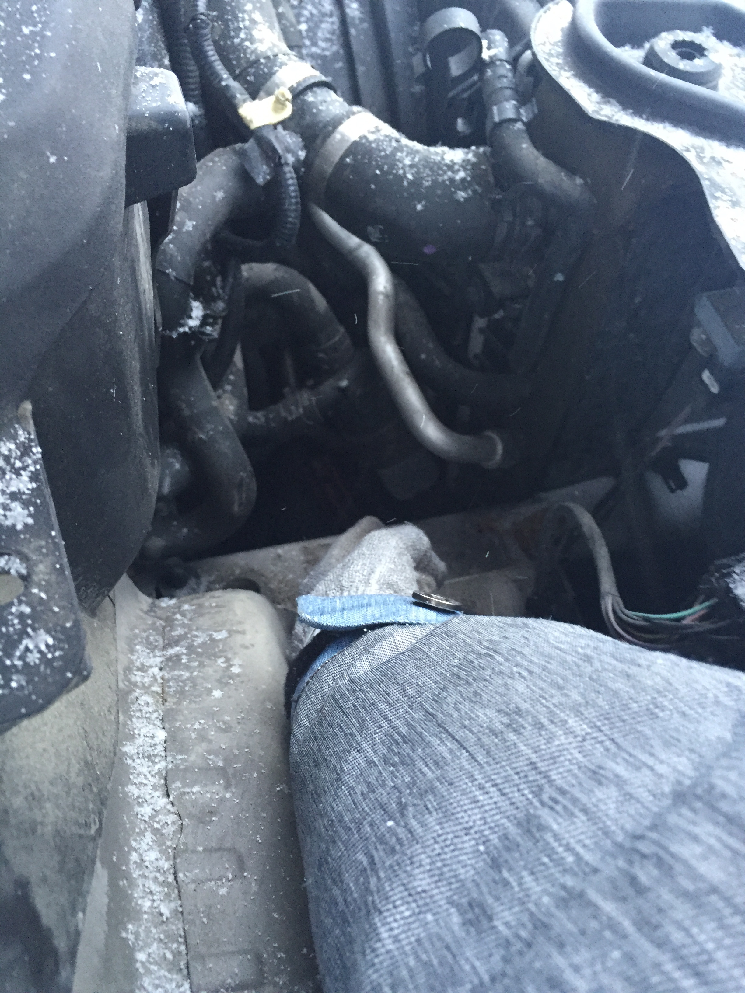

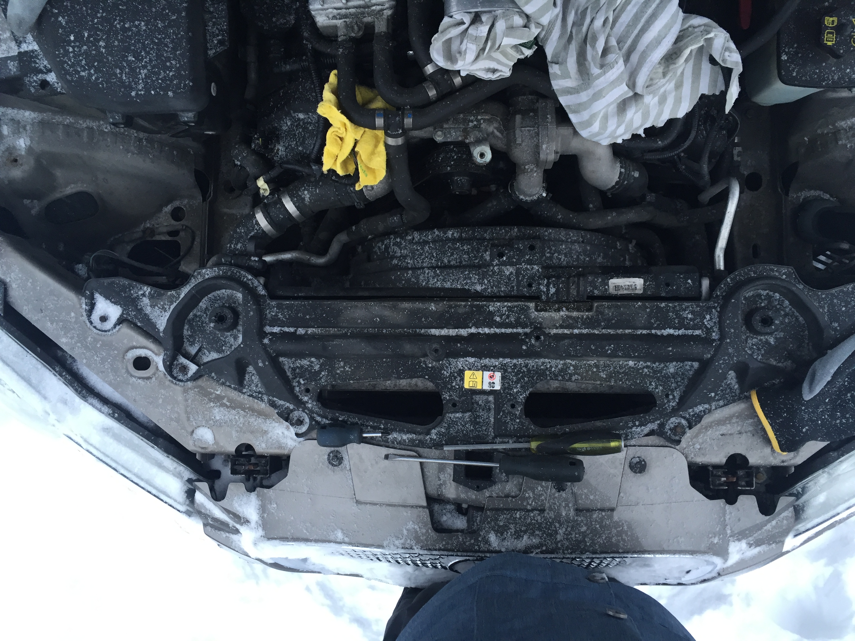

and here's some picture of how I proceed.
++ BY THE WAY don't do like me and disable the whole intake system on both side of the car. the pump is located on the passenger side of the engine so just take off the air filter cabin and the rest that goes to your radiator and you will see it.
