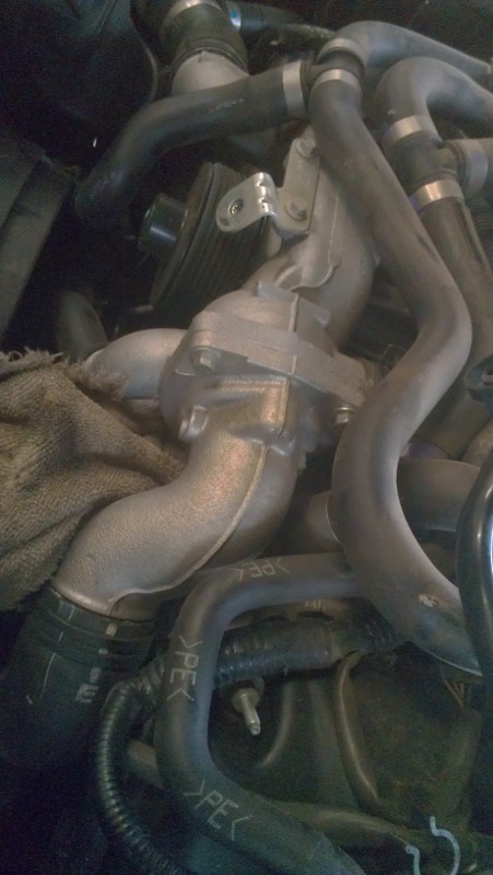

Intake removed - thermostat housing is by the rag:
Better angle of just the housing - notice three bolts and the hose clamped to the bottom.
It's easier to remove the clamp if you don't loosen the bolts first, so get your pliers on there, squeeze the spring clip together and slide it down the hose a short ways so the hose is no longer clamped. An old mechanic's trick is to then grab the hose itself with the pliers where the clamp was, and give it a little twist in case it's stuck. If you don't remove the cap from the overfill tank, it should keep the coolant from leaving quite so fast. When you pull the hose free, you'll lose a few cups, I limited it by sticking a rag into the hose once I had it loose.

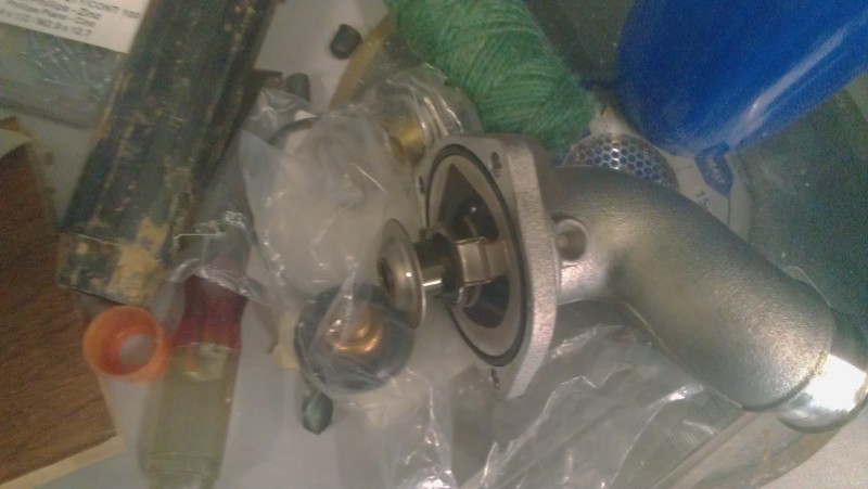

Removed thermostat housing on bench:
Here's a view of how the thermostat, assembled, sits in the housing, for reference, since the replacement comes in 4 pieces:

See the black rubber seal that's come loose? That allows coolant to bypass, and prevents the engine from coming up to temp as fast - not a big deal, but it effects fuel efficiency - and worst of all causes a Check Engine light that would obscure any more severe problems.
- Notice the retaining ears on the thermostat housing - you'll need to push the thermostat in, and twist to free it - it's a little tough to remove, but just tell yourself that's to prevent it coming loose while you're going down the road.

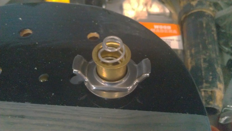

Preassembling the new thermostat pieces:
The new thermostat has a pin, just visible, that fits handily in a special made bit in the housing designed for that purpose. Then just twist the second piece on into those retaining ears we talked about before, and the job is done.
Next use a flat screwdriver (gently!!) to remove the round rubber seal from the thermostat housing, and replace with your new one - it just sits in there, and it doesn't seem possible to mess up.
