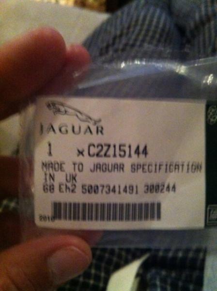

So I have been trying to personalize my XF SC and thought this was a good edition. Might be the first in the states. I got two, one for the trunk and other for the grill.
Attached Thumbnails Look what Santa brought me (S badge)-0ca9aa3a-cd09-4be2-8e02-6a30d43b2aa0-627-00000074168fddbf.jpg   Look what Santa brought me (S badge)-e676106c-6940-4a76-aaf2-46a62a872a8b-627-0000007408b132fb.jpg

Car is stock right now outside of Mina Exhaust. Ordering rear diffuser, grill, and pulley next week.
I got them on eBay UK from a Dealership (Sturgess) in the description they said they don't ship to US. so I called and asked if they would. It took a lot of convincing as they said they were not allowed to ship. But after a few phone calls they ended up shipping. The badge is what they put on the UK spec Jaguar XF diesel SC.
