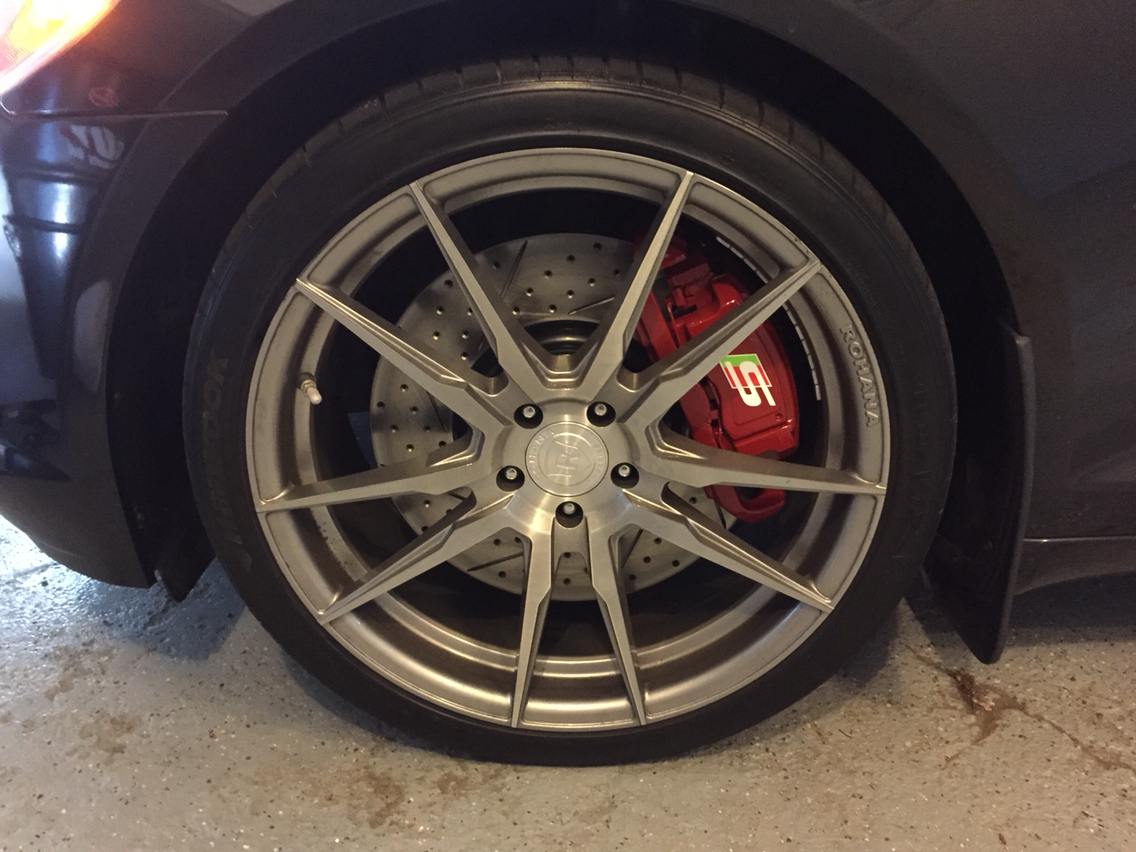

My thread from a few years ago. for my old 2010 Premium V8 (non-supercharged).
https://www.jaguarforums.com/forum/x...-5-0-a-140891/
Brakes (in black).
Full Kit Black Hart Drilled Slotted Brake Rotors Disc and Ceramic Pads XF XJ XK | eBay
You can get the same thing in either gold or silver also.
Brakes (in black).
Brakes (in black).
Brakes (in black).

![Default](/forum/images/icons/icon1.gif)
Yes, I would buy them again if I needed to. The slots give you a very slight pedal vibration and a very faint clicking noise (very slight and very faint), but you get that with any slotted/drill discs.
They perform great.
