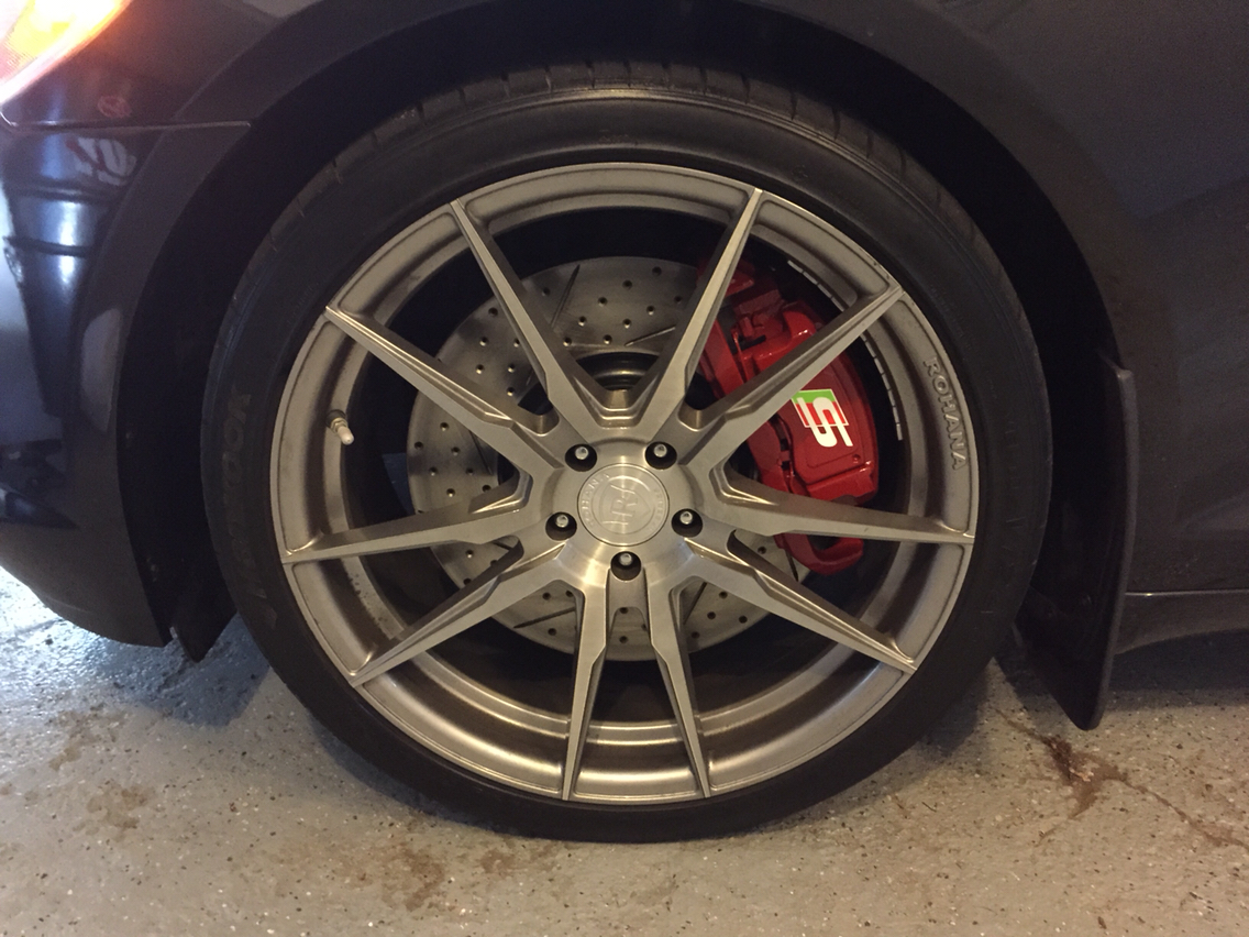

I got a set of Rohana RF2 staggered setup for my 2010 SC. Been very happy with them. Great fit with the rears sticking out a little more than stock for a better look. Couple of photos below - if you search there is a whole thread on these
If you go for anything else make really sure it fits first. Brake clearance on front wheels is very tight
