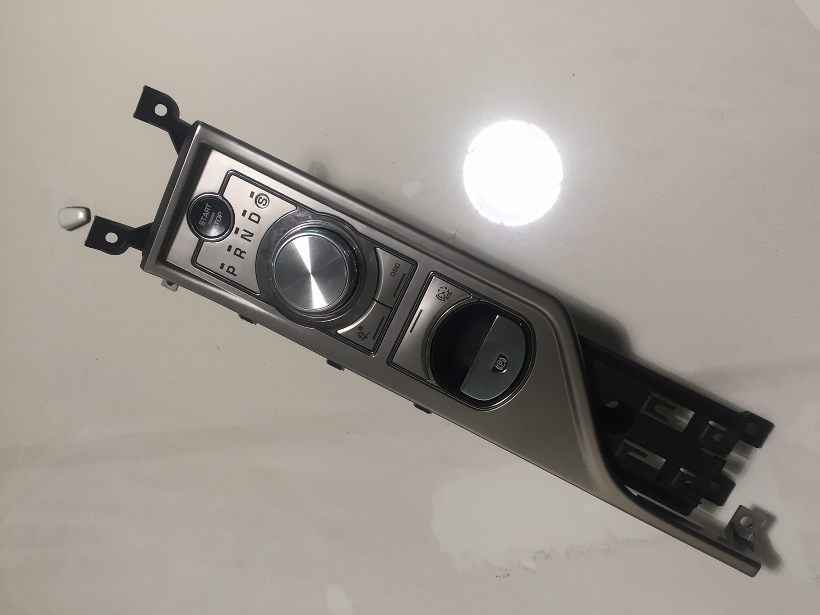

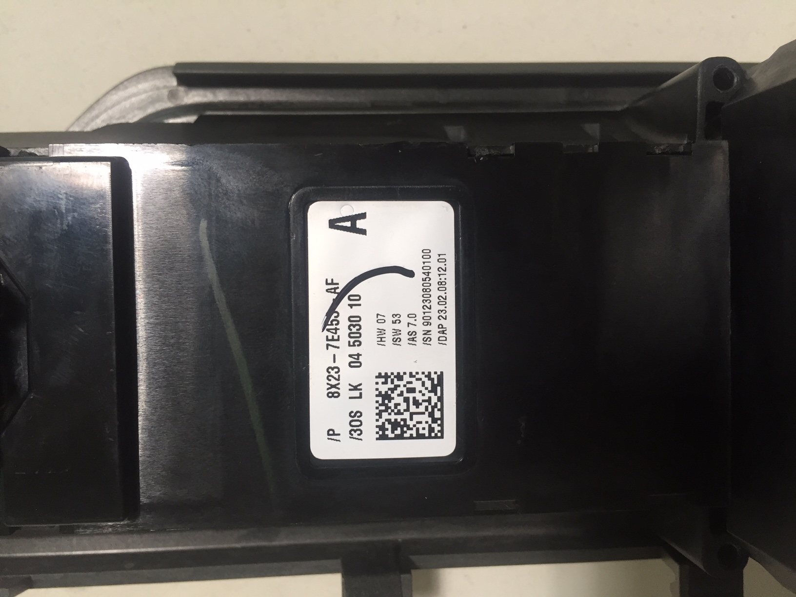

I've came across many parts with P/N C2Z18713 on eBay that say it fits XF 2009 3.0L LHD do you think it is the same part ?
specially it has the the same number as mine on the part's back /P 8X23-7E453 -AF
attached is the back of my faulty part for your reference...
