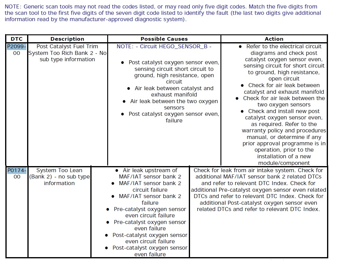

This is the Jaguar DTC listing for P0174 and P2099 on the 2009MY.
![](https://www.jaguarforums.com/forum/attachments/xf-xfr-x250-44/72290-what-fix-when-you-have-code-p2099-p2099.jpg?amp;d=1392286386)
With the 7-digit DTC's now in use, the final '00' on both of these codes shows no additional information would be available through the dealer SDD and a generic 5-digit scantool is adequate.
A number of potential leak locations are given together with the possibility of a harness fault contributing to the codes.
A concern is the mention of 'warranty' on the post catalyst HO2 sensor suggesting this could be a known failure.

I didn't find it the way it looks in post #2. I extracted the appropriate info for the two codes from the Service Manual.
Back in the days of JTIS (Jaguar Technical Information System), the DTC listings were available as a full list PDF which was a very convenient way of looking up the error codes.
Now that Jaguar used SDD (Symptom Driven Diagnostics), this type of full list isn't available for models after 2006 or if it is, I haven't been able to find it.
It makes me think that going through the Service Manual and putting a full list together in the style of post #2 could be very useful.

A Jag tech reported that the 09 SC is known for having a issue with the O-ring behind a brass fitting for the brake booster pipe where it goes into the elbow before the SC under the throttle body.
Check out this thread: https://www.jaguarforums.com/forum/x...ht-came-65822/
