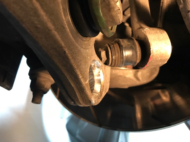

I finally got to the bottom of the steering judder when braking. Took all the normal brake related actions but no resolve.
I could not feel any suspension or steering wear using levers and bars but a couple of weeks ago I drove over a very large rain gulley at the end of our street and "BANG" something happened on the right front wheel. Turns out it was one of the bushings pulled out of the lower suspension link, the one that houses the lower ball joint, coil spring/shock and front stabilizer. The bush that popped holds the link that goes to the top suspension wishbone. Have included pics and it shows the bush has been loose for some while as the surfaces were polished.
Fitted two new links ( expensive) and judder has gone away.
NOTE - If you do this job make sure you mark the position of the bolts that go thru the very large bushing in the link and connect with the frame, if you do not put back in same position it will affect the wheel camber. Also best have an alignment done anyway.
Attached Thumbnails XF Brake judder, good rotors-img_1338.jpg   XF Brake judder, good rotors-img_1339.jpg   XF Brake judder, good rotors-img_1340.jpg

Interesting but makes no sense.
this is the sway bar bush and does not effect alignment if replaced, it connects the sway bar drop linksbto the lower arm.
it also cannot cure vibrations, the vibration is caused by rotating parts not by a rubber bush.
I believe that this is not the real cause of the problem you have

You are partially technically correct and it does make some sense if the lower links are replaced which mine were alignment is necessary. The positions of the eccentric bolt system that connects the lower link to the frame as incorrect position on re installation changes the camber, hence the need for alignment or at least checking the camber.
Yes everything pointed to a rotating component problem and to solve the problem I am on my second set of new rotors and pads in 5000 miles, I had no rotor or hub run out problems, all less than 0.001" I also had one wheel straightened that had 0.050" run out and rebalanced, hub bearings appear to have no play. Brake calipers rebuilt and a fluid flush too. The problem has now changed brakes are smooth at lower speeds but now get more noise with high speed braking but with no steering wheel judder or brake pedal pulsing.

The bush is the anti roll bar bush........the arm you refer to is the lower laterral arm.......did not realise you replaced the arm......why did you not replace just the bush? Would have been much cheaper

Good point indeed. There are three bushes in the lateral link, one for the pivot to the frame, another for the strut and this bushing. There is no steel outer for this bush so it is not an interference fit. I believe and I may be wrong, this bush is bonded in place as the arm that is fastened to it that goes to the anti roll/sway bar only has a bolt going though it so has to be bonded or something to keep it in place and not pull out which is exactly what mine did.
Another reason I replaced both lateral links was again with the problems I have been having just thought it wise to replace

That's fair comment on the replacement arm - its was the referral to the anti roll bar bush that confused me - the small rubber bush that goes onto the anti roll bar drop links is way to soft in my opinion - I'm looking at replacing mine with some POLY versions - there are none on the market that I can find so looking at getting a cotton reel off the shelf one that works with a steel insert sleeve - I'm not actually convinced they are bonded in as well - I believe they are just a tight interference fit............
