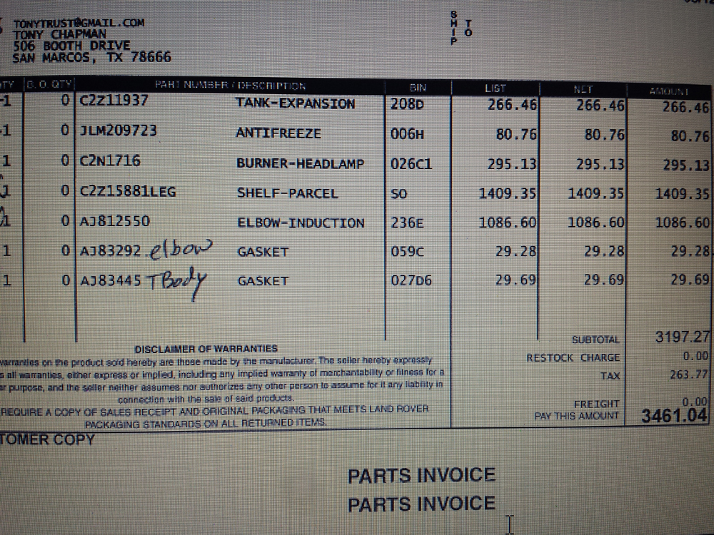

Can anyone help me find the rest of the parts I need to complete the repairs on my car. I don't want to buy them from the dealership. I already purchased the tank. I just need the headlight and the induction elbow. I'm not going to worry about the sun visor lol. I attached a copy of the work order I paid for from the Jaguar dealership which includes the part numbers. I don't have to have OEM parts. Links to where I can find these items would be greatly appreciated. Thanks gentlemen
![XF SC 36,000 miles problems are popping up-20140818_202217.jpg](https://www.jaguarforums.com/forum/attachments/xf-xfr-x250-44/93454d1480973518t-xf-sc-36-000-miles-problems-popping-up-20140818_202217.jpg)

Contact these guys: SNG Barratt - The Ultimate Jaguar Parts Specialist
They have a very good reputation with my Jaguar club.

Our website www.sngbarratt.com will recognize all original part numbers and also has an interactive search facility. You will then be able to see pictures and prices for OEM & aftermarket items where possible.
Also remember you get 10% off list with your JF membership![Smile](https://www.jaguarforums.com/forum/images/smilies/smile.gif)
If you need any assistance please do not hesitate to give us a shout.

UPDATE:
Replaced HID headlight for $100
Replaced COOLANT WARNING SENSOR part number C2Z6566 $15
Jaguar of Austin wanted to replace the whole EXPANSION TANK even after I told them I smelled no coolant and I had been monitoring my coolant level for 4 weeks and the level stayed the same. They even told me that the sensor probably went out. After knowing all this and even checking out my car themselves they still wanted to change the whole tank. I went to the Jaguar dealership in SA and bought a $15 sensor and popped that sucker right in and my warning light went off.
Now I'm wondering if I even need to replace the induction elbow or simply replace the gaskets.
