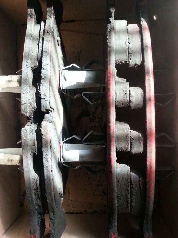

It sounds like you have the exact same thing I have, wheel shake, mostly from high(ish) speed, worse when the brakes are warm. I have OEM discs and I HAD red stuff pads. I've since changed the pads as after only 10 months, the inside pads are completely shot (down to 1mm), however, the outside pads are ok. I went on one half-day track event. Otherwise I'm pretty light on the brakes.
Changing the pads hasn't really helped. I'm going to have to change the discs as well. I've been chatting to Spires here in the UK and they really don't rate Red Stuff for the XRF.
Here is a picture of my front pads (thin pads are the inside pads, thick pads outside)

Check the caliper slides. If they are frozen, they do not allow the outer pad to apply adequate pressure.
![Default](/forum/images/icons/icon1.gif)
I thought calliper slides, but then thought it makes no sense as the outside of the disk is fine so the calliper has to be sliding OK......the inner brake pads have to react against the inner surface to slide the calliper and pull the outer in......but it looks like the inners are barely being touched.
I do have a new theory......looking at the service history the brake fluid has never been changed in 60k miles......wonder if the old possibly sludged up thicker fluid is stopping the pistons fully retracting and being held on the inner face at stops......hence the spotting.
