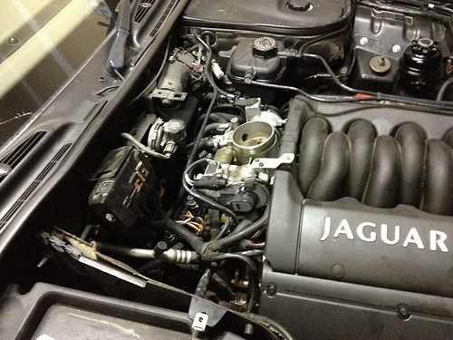

-Start by jacking up the car and securing it with jack stands.
-Drain Coolant

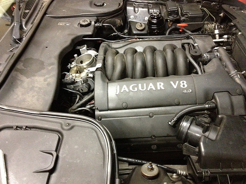

-Remove the intake pipe, this consists of removing 2-8mm bolts, the breather hose, and clamp by the airbox.
![](https://www.jaguarforums.com/forum/attachments/xj-xj8-xjr-x308-27/39460-x308-heater-hose-repair-8642250400_880154f2cb.jpg?dateline=1365741083)
-Remove the plastic center cover by behind the throttle body

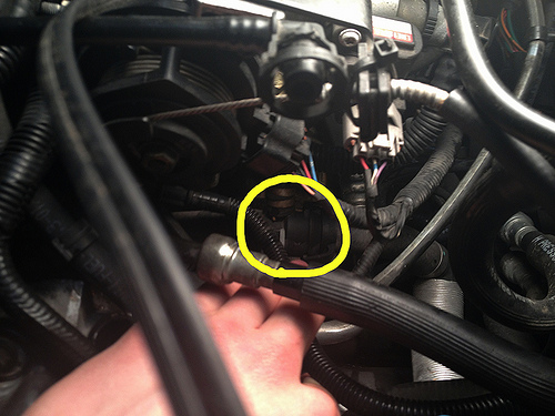

-After the Coolant has fully drained, start to remove the Coolant reservoir
-Remove the 3 hoses that connect to the top of the reservoir, be patient with these, so you dont break one.
-Remove 2-10mm bolts that secure the reservoir
-Remove the Electric connector
-Remove the hose on the bottom of the reservoir, this is held on by a hose clamp.

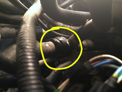

-Remove the hose that connects to the water valve

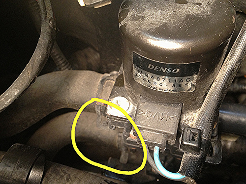

-Remove the hose on the back of the water valve

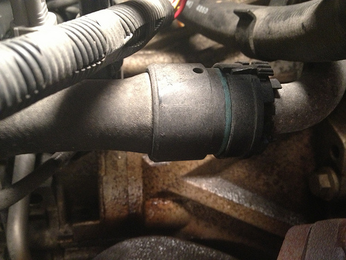

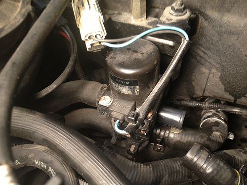

-Remove the hose that connects to the engine under the throttle body, this is held on by two clips on either side of the hose, pry the clips apart to release the hose.

The following with illustrations is meant as supplementary information. (on the JPEG files - when the dropbox webpage opens, click on the image to get a better view).
Removal of Intake Air Pipe - This is a PDF file that has instructions/illustrations to Remove the Air Pipe section starting from the top of the Throttle body to the top cover of the Air Box (Air Cleaner).
https://www.dropbox.com/s/3f6qwc2ut7...pe%20R%26I.pdf
Plastic Center Cover (Engine Center Bulkhead) Removal - JPEG file that has a listing of the Bulkhead parts with illustration.
https://www.dropbox.com/s/9jqch1wflw...lustration.jpg
Side note: Dani - looks like in photos - the Bulkhead Cover Fastener parts are missing that hold down the Center Bulkhead Cover.
Part# KRH100005 - Fastener
Part# KRF100006 - Stud retainer
Coolant Reservoir (Expansion Tank) Removal - PDF file with instructions/illustrations.
https://www.dropbox.com/s/71ovnenhg2...20%20R%26I.pdf
No need to do step 11 - removal of Coolant Sensor (unless you need to replace it).
Here is also a JPEG file of the Coolant Reservoir/hoses parts:
https://www.dropbox.com/s/wcjdseyepq...%20numbers.jpg
-Drain Coolant
![](https://www.jaguarforums.com/forum/attachments/xj-xj8-xjr-x308-27/39463-x308-heater-hose-repair-8642263708_b43a8db04f.jpg?dateline=1365741083)
![](https://www.jaguarforums.com/forum/attachments/xj-xj8-xjr-x308-27/39464-x308-heater-hose-repair-8642261956_4131cf4737.jpg?dateline=1365741083)
![](https://www.jaguarforums.com/forum/attachments/xj-xj8-xjr-x308-27/39465-x308-heater-hose-repair-8642258768_f1638051fe.jpg?dateline=1365741083)
![](https://www.jaguarforums.com/forum/attachments/xj-xj8-xjr-x308-27/39466-x308-heater-hose-repair-8641159223_4d812912d2.jpg?dateline=1365741083)
-Remove Hose on the passenger side above the down pipe, press down on the top of connector, and slide it back towards the hose, then give it a good pull.
![](https://www.jaguarforums.com/forum/attachments/xj-xj8-xjr-x308-27/39467-x308-heater-hose-repair-8641164537_56c92de014.jpg?dateline=1365741083)
