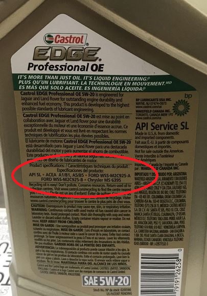

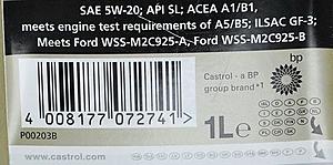

I learned The oil requirement changed 2013 to 2014 which could account for the difference between what is in my owner's manual and written on the oil fill cap. I guess I'll have to check by the serial - vin number. My car is a late 2013

2014 JAGUAR XJ 3.0L 6-cyl Engine Code [D]
minus.jpg LUBRICANTS & FLUIDS:
Engine Oil
Grade 1......SEO14[1] No AMSOIL Product Recommendation
All TEMPS......5W-20
Below -4 F......0W-20
Automatic Transmission,8HP70......SL093 [2]
Signature Series Fuel-Efficient Synthetic Automatic Transmission Fluid (ATL) (ATLQT)
OE Fuel-Efficient Synthetic Automatic Transmission Fluid (OTLQT)
Differential, Front......GLS24 [3]
All TEMPS......
SEVERE GEAR 75W-90 Synthetic EP Lubricant (SVGQT)
Differential, Rear Electronic Unit......GLS16 [4]
All TEMPS......
Differential, Rear Open Unit......GLS24 [3]
All TEMPS......
Transfer Case,U/K TRC......GLS87 [5]
Fluids
Brake Fluid......HBH
AMSOIL Brake Fluid DOT-4 (BF4SN) [6]
Power Steering Fluid......PS035
Signature Series Multi-Vehicle Synthetic Automatic Transmission Fluid (ATF) (ATFQT)
OE Multi-Vehicle Synthetic Automatic Transmission Fluid (OTFQT) [7]
[1] Use motor oil meeting specification WSS-M2C925-A, WSS superseded by WSSM2C945-A
except in
locations where temperatures fall below -4 F (-20 C). If
unavailable, or in locations where temperatures fall below
-4 F (-20 C) engine oil meeting Jaguar Land Rover
specification STJLR.51.5122 should be used.

Ecamiel, I am searching for the correct oil to put in my 2014 V6 3.0 L SC and have pulled up your thread. Castrol customer service advises that the Castrol 5W-20 Professional OE with spec WSS M2C925-A is the specified oil to use for my car. That is confirmed by the dealer. Castrol does not advise using Castrol oils adhering to WSS M2C945-A and say that the two specs are significantly different. Castrol does not agree with your info above and does not recognize that WSS M2C925-A is "superseded" by WSS M2C945-A and want to see something official from Ford or Jaguar confirming this info on letterhead.
Please advise what your source was for this information.
I'm trying to buy oil by the quart. I can find commercially available Castrol oil meeting the WSSM2C945-A spec. My local Jag dealers that have WSSM2C925-A only buy it in bulk and can't sell it to me by the quart.
![Default](/forum/images/icons/icon1.gif)
[QUOTE=Freddy J;1884860]Ecamiel, I am searching for the correct oil to put in my 2014 V6 3.0 L SC and have pulled up your thread. Castrol customer service advises that the Castrol 5W-20 Professional OE with spec WSS M2C925-A is the specified oil to use for my car. That is confirmed by the dealer. Castrol does not advise using Castrol oils adhering to WSS M2C945-A and say that the two specs are significantly different. Castrol does not agree with your info above and does not recognize that WSS M2C925-A is "superseded" by WSS M2C945-A and want to see something official from Ford or Jaguar confirming this info on letterhead.
on the phone Pennzoil say a 2014 (not 2014) takes WSSM2C925-A. M2C945-A has superseded that I think. The other information, including the "supersedes" is from the Amsoil web site. Castrol would give me NO information and Jag dealers want from $600 to $900 for an oil change
I smell a rat
I smell a rat
Yep you hit the problem on the head.
Very few oils meet the WSS M2C925-A spec.
I also thought the later WSS M2C945-A spec would have superseded the 925 one BUT can't find that in writing anywhere. So we are back to getting it from the dealer (if you can!) for whatever they charge.
It's on EBay too but at $19/L!
https://www.ebay.com/itm/Castrol-Edg...53.m1438.l2649
Here it is for $80/6 pack!
https://www.ebay.com/itm/Castrol-Edg...sAAOSwyCla0LVm
