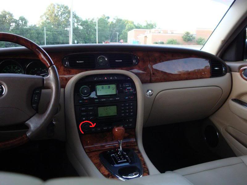

Badda-bing! Problem solved.
Cool beans, glad you fixed the problem
