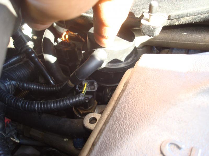

But my problem now is the blow off/bypass valve. I have the car all put together and when the car warms up the valve opens and makes a constant screeching sound? i didn't take it apart. just took 1 bolt off so i can remove whole unit form throttle body mounting plate.
the "problem" piece is the part my finger is touching. Sorry if i don't know the proper name. I am doing this for my mom.

The cars "restricted performance" light came on. I read threads and the one concensus was to OBD it, get codes then clear it and see if it comes back. Check, check, and check... As of now restricted performance light is off. but check engine is on. codes i got were P0171, P0405 and P0174. So with recommendations from the forum in other threads i looked for obvious leaks (thats all i'm skilled enough to look for) and right away i see my engine airfilter box is broken.

Sorry Michael, air leaks are always threatening these cars, I've gotten really good at locating them with a live data stream of the short term fuel trims and a can of MAF cleaner. at my disposal. The trims jump to double digits immediately in response to a little MAF getting sucked into a broken line or ill-sealed gasket.
