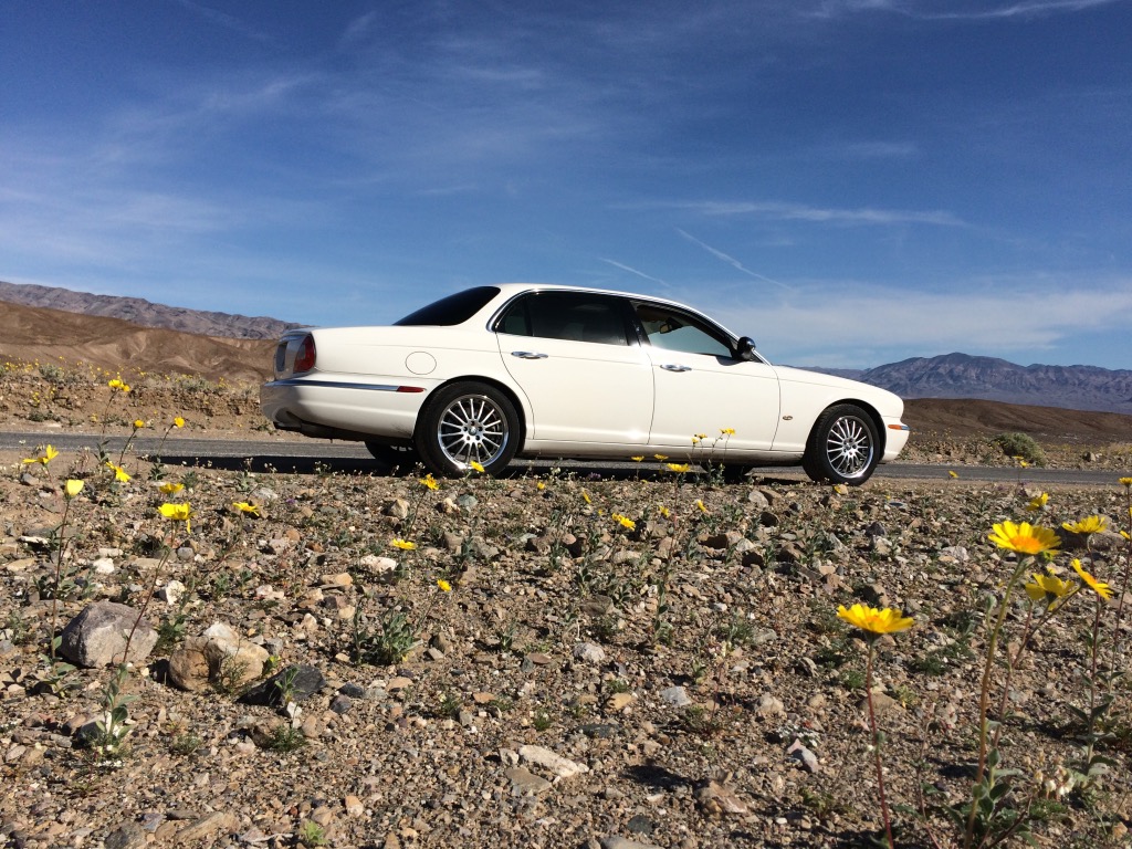

That's crazy! It looks like the mount on the spring perch snapped. I haven't had an issue with mine, but I did notice your first completed pictures shows your car sitting lower than mine after a few thousand miles. My height is still the same as these photos 6+ months later. I'll definitely inspect my spring perches tomorrow.
