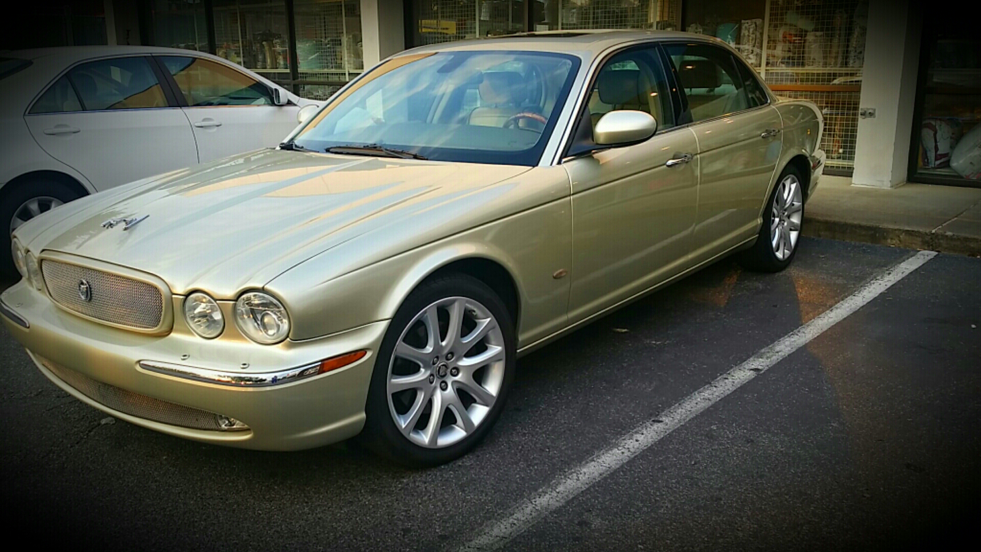

Old 10-10-2016, 07:41 AM
Marque's Avatar
Join Date: Jul 2014
Location: Memphis
Posts: 622
Received 150 Likes on 120 Posts
Twins...
Attached Thumbnails 2006 xj8 vs 2008 xj wheel fitment-2016-06-12-03.12.33.jpg   2006 xj8 vs 2008 xj wheel fitment-2016-06-12-03.11.52.jpg
