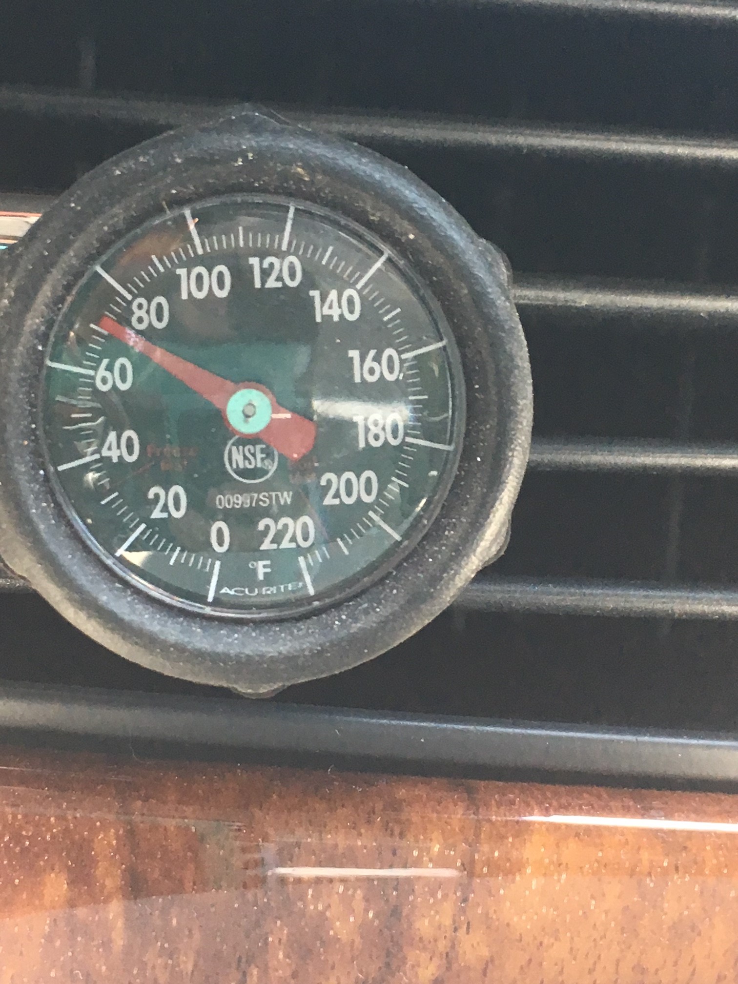

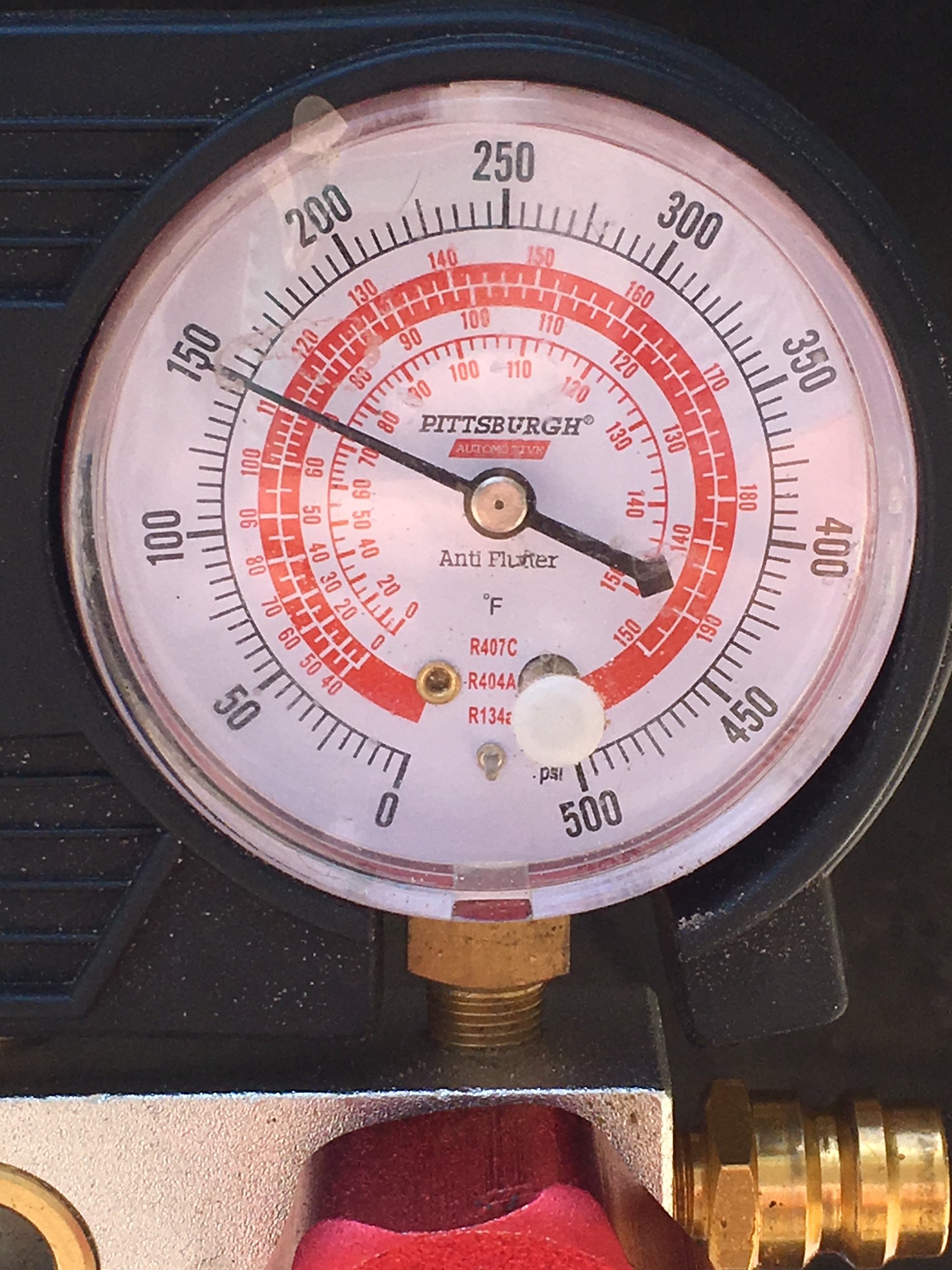

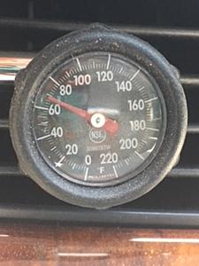

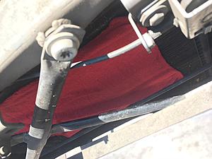

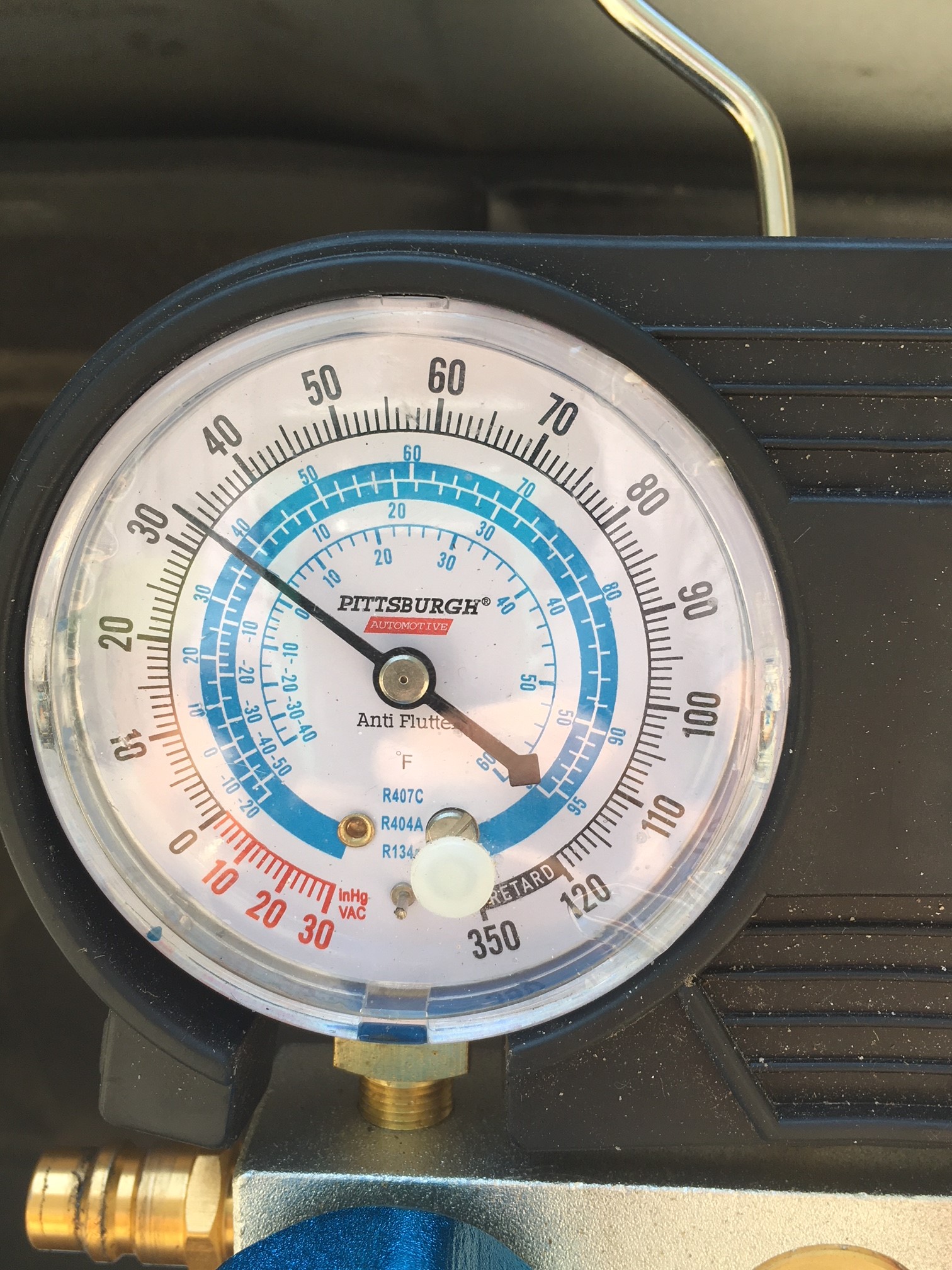

Thank you for the tips. Here are the results. I pulled the car out of a 74 degree garage into 97 degree full sun heat. Drove the car for about 5 miles to get the engine up to operating temperature. Air conditioner was set to 'LO', recirculating and high fan. Don't pay attention to the ambient temperature on the control panel, it takes a long time to accurately reflect the outside temperature after it comes out of the garage.
Car was cooling well when pulled out of garage, (Duh). Pulled the car back to shop and left on hot concrete in full sun. First thing was to try the rag test, which the fan held the rag to the condensor easily - actually sucked it onto the condensor. I replaced the black cover after removing the rag for the remaining tests.
Second, hooked up the gauges with these initial readings on the outer black scale: 32 /252
Third, here is the vent temperature reading prior to misting: 68 degrees
Fourth, after misting cool water on the condensor, here are both readings: 25 / 145
Fifth, here is the vent temperature after the misting of the condensor: 68 degrees
When I misted the condensor, I heard the fan go into a slower mode almost immediately. After I stopped misting and it dried off, the fan kicked back into high speed.
After sitting on the hot parking lot running full AC for about 30 minutes, the low pressure was 41, the high pressure was 300, and the vent temperature gauge read 90 degrees and climbing. The cooling fan was running on high based on the sound.
I don't know what to make of this information - scheduled to go to independent mechanic on Tuesday.
Thank you for any help.

Hi NDW,
I'll defer to mhamilton when he gets a chance to reply, but in the meantime it looks to me like your low pressures are too low and your high pressures are too high, at least relative to one another. In other words, as high as your high pressure is, I would expect to see the low pressure higher. One possible cause of those readings is an obstructed expansion valve/orifice.
Another observation is that a possible reason your vent temperature began climbing toward ambient is that with a refrigerant high side pressure above 300 psi the pressure switch may have disabled the compressor. If I understand the Workshop Manual correctly, in the X350 a single pressure switch connected to the ECM disables the compressor when the refrigerant pressure is too high or too low.
I'll be interested in what mhamilton has to say.
