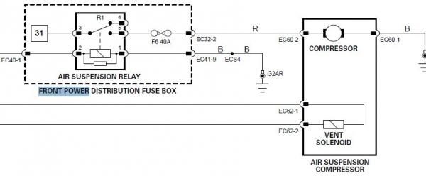

for a check of the compressor, it is not necessary to dismount the front left wheel and all that.
You can as well give +12V to fuse 6 of the front power distribution fuse box and let the compressor run.
![](https://www.jaguarforums.com/forum/attachments/xj-xj6-xj8-xjr-x350-x358-28/89164-air-shock-compressor-rebuilt-but-still-air-fault-vehicle-too-low-1-leojagger-145926-albums-front-power-distribution-fuse-box-9686-picture-air-suspension-relay-26.jpg?dateline=1403720489)
To test the compressor, perform the following steps:
- Prepare a a thick cable, one end needs a clamp (for the battery), the other end should be a soldered tip (to touch the fuse)
- If you like, you may install a cable fuse of 40 Ampere
- Make sure that the ignition is off, because then relay R1 is open
- Fix the clamp on the plus pole of the cars battery, be careful not to touch anything with the other open end
- Contact the open end to the metal of fuse 6 for a second and hear the compressor snarl
![](https://www.jaguarforums.com/forum/attachments/xj-xj6-xj8-xjr-x350-x358-28/89165-air-shock-compressor-rebuilt-but-still-air-fault-vehicle-too-low-2-leojagger-145926-albums-front-power-distribution-fuse-box-9686-picture-front-power-distributio.jpg?dateline=1403720489)
Please do not let the compressor run too long while the ASM is in sleep mode.
If the compressor keeps silent, there is something wrong with either:
- fuse 6 of the front power distribution fuse box
- the corresponding connector EC32-2 of the front power distribution fuse box
- the cable to the compressor
- the connector EC60-2 of the compressor
- any of the ground (earth) cables/connectors behind the headlamp (G2AR) or of the compressor (G1BS)
- the compressor itself
Be careful - I hope this description is complete.
34by151, if you are reading this, could you please check it ?
Good luck

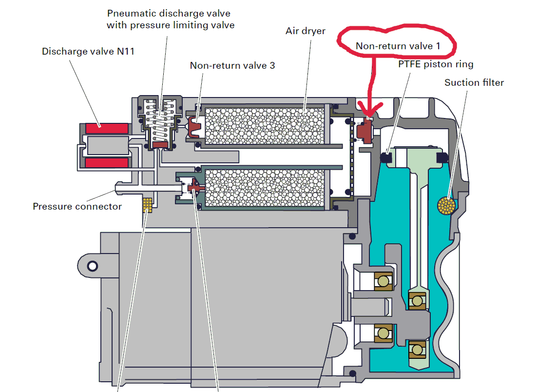

Hi hawaiianjag,
the ring may look worn quickly as it rapidly rubs the cylinder but it should be polished all the way around the profile, it will be uneven as it tilts but should be a smooth polish mark around the circumference,
not sure abnout the rust bit you talk about but i dont think it is any problem, as long as it is not in the cylinder, bu in the piston rod end.
I suggest we need to check the pressure from the compressor to prove if it is ok or not, best way is to apply 12v to the main motor plug and use a guage to read the output pressure is an ideal method, it should hit 200+ psi after 10-15 seconds running, but simply a finger over the output hole will give an "idea" if good pressure it will blow your finger off the end, it is a problem if you can keep your finger on the end easier,
if compressor is bad next we check the one way valve in the drier unit, let me know what you find, and will try to help
regards

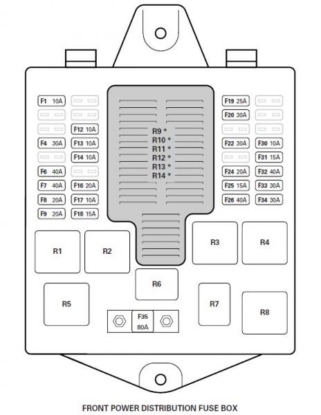

Thanks again, 34by151 !
The relay pins are labeled in the electrical guide :
![](https://www.jaguarforums.com/forum/members/leojagger-145926-albums-front-power-distribution-fuse-box-9686-picture-relay-r1-2-26222.jpg)
and underside the relay as well :
![](https://www.jaguarforums.com/forum/members/leojagger-145926-albums-front-power-distribution-fuse-box-9686-picture-relay-r1-4-26223.jpg)
Of course you know that you have to check the socket, not the pins of the relay.
Remember that pin 2 only gets +12V when the engine is on and there is not enough pressure in the system (the compressor has to run).

I just got back from a trip and can't locate my ohmmeter to do the tests the mentioned. I also have never really messed with electronics of a car so I'm a total newbie when it comes to testing a fuse port ( I did look to see if fuse 6 was blown- it was fine)
I was thinking about swapping the R1 relay with one of the orange ones next to it to see if that does anything in the meantime...
I can't get the compressor to come on once I've jacked the car in the air so I assume I will be forced to use the car's battery to rig up what the other posters have mentioned in order to get the compressor motor to come on.

You will get the spade plugs at an autoshop as well as a crimper
Just crimp the plug on the wire
All you are doing is simulating the relay closing by using the wire

from your desctiption it sounds like poor pressure for some reason, a good compressor you can push your finger against the outlet hole but it will blow your finger off the end after 5-10 seconds,
if the compressor output feels poor then we can check a few things 1st:
i know it sounds silly
![Smile](https://www.jaguarforums.com/forum/images/smilies/smile.gif)
the compressor should hit 200 psi after 10-15 seconds running so again make sure it runs for at least this time to feel this.
is their a little pressure or nothing at all?
what condition was the cylinder is, badly scored or smooth?
if definetely poor pressure, next step is to ensure the piston ring is fitted the correct way, you must be able to see the small timing pin in the end of the pistin groove, if upside down it will not work well at all. also make sure it has rub marks all the way around the diameter to make sure it is fitting correctly
next suspect is the one way valve at the top of the cylinder, see section:
Attachment 90707
unbolt the plastic drier unit from the cylinder head (2 x 10mm nuts & long bolts) and remove the stainless plate in the back of the cylinder to expose the one way rubber valve and spring, make sure it is clean and spring is intact,
if these check out ok there are a few more things to check/clean
- n11 valve leaking
- remove beads chamber and check spring is in the end,
- pressure release valve (white plastic cap has 2 springs and rubber pressure valve)
- cracks in the plastic drier body
Attachment 90707
Attachment 90707
- n11 valve leaking
