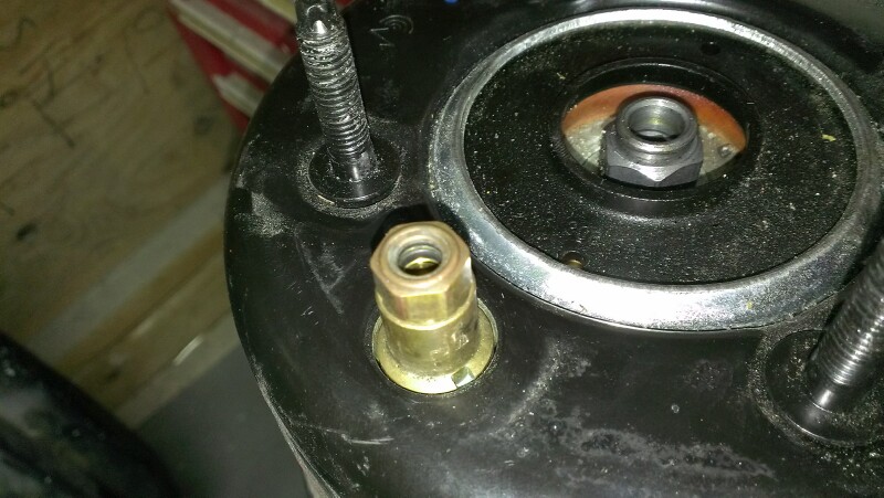

I finished the right front shock in about 45 minutes. I did find one tricky thing when using the Arnott shock. They include a new air fitting on the shock. You unscrew the nut, slide the air line through it and retighten. I didn't have a problem with the rear shock I replaced last spring, but when I went to unscrew the nut this time the whole fitting started to unscrew. If the shock was out of the car you could just grab the fitting with pliers and unscrew the nut, but you can't really do that with the shock in the car, and Arnott says removing the fitting will void the warranty. You need to make sure you can remove the nut before you put the shock in the car unless you want to take it out again.
The fitting does have two notches at the base and I managed to hold it with circlip pliers and loosen the nut.

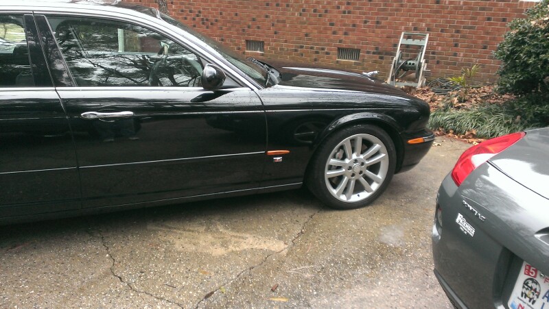

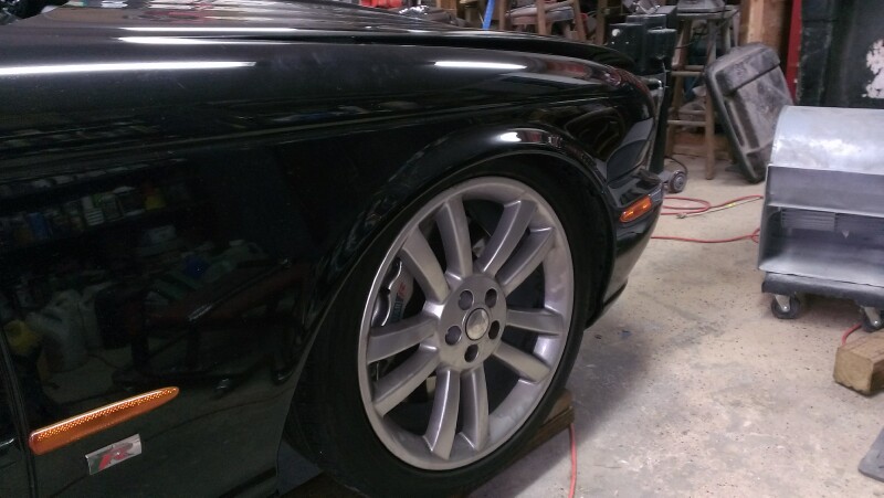

Car before new shock -
Car after new shock -
Attached Thumbnails Air suspension advice-shock1.jpg   Air suspension advice-jaglow1.jpg   Air suspension advice-jaglow2.jpg
