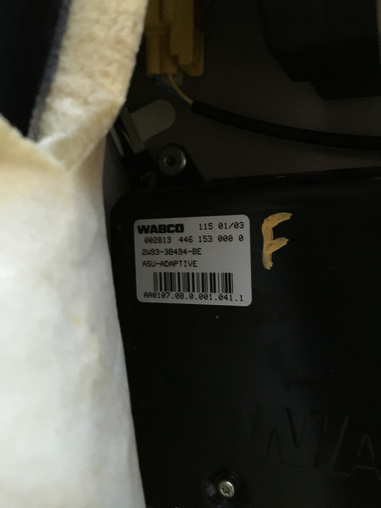

Wabco in place; photo attached.
Thanks.

Try to upload again ....
