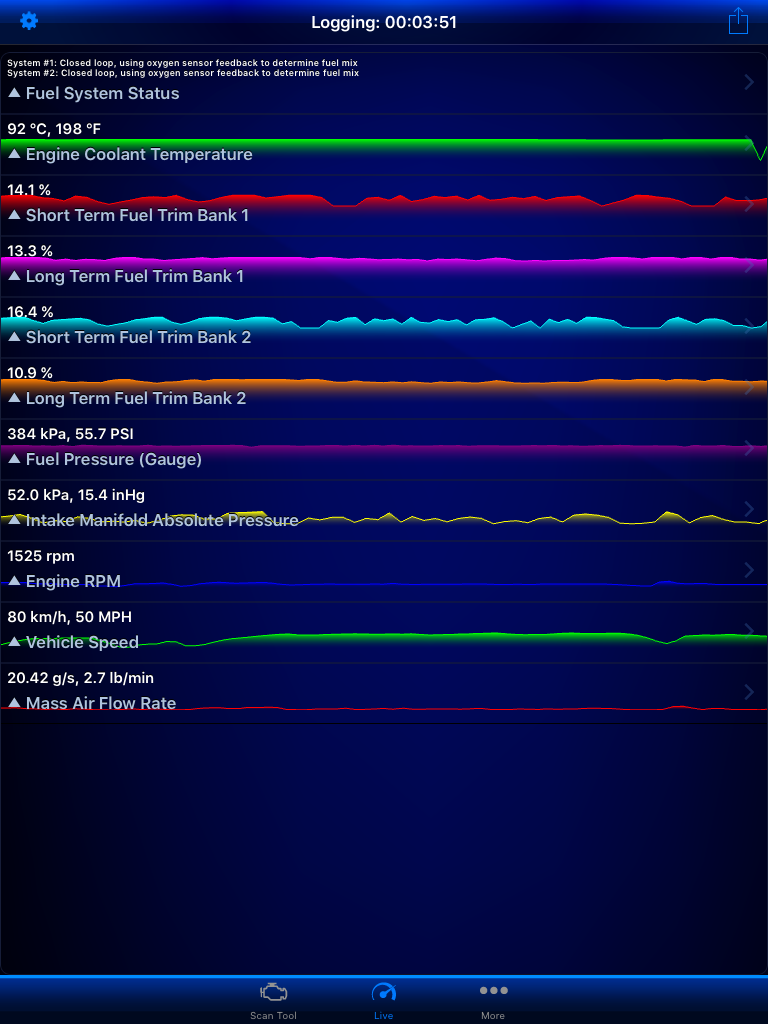

Hi all,
I know there are a few threads out there on this topic, but thought I'd post one unique to my situation rather than hijack someone else's. I've read through most of them so will be using those tips as well as the info in the DTC and workshop manuals for them.
Still, i'll be seeking advice perhaps on some of the finer points of troubleshooting or what direction might make sense to go in vs. another.
Basically these indicate banks 1 and 2 are running lean. To recap, the DTC summary gives the following possible causes:
. Air intake leak between

To this point, I just have glanced over it and cleaned the MAF sensor with the spray they sell for that purpose. Replaced the air filter while i was in the area. If anything, I have made it slightly worse so I suspect either the MAF was really going bad and i just tipped it over, or I've introduced a leak there between the MAF and the intake. I didn't think so, but I'll doublecheck.
here is a screenshot of the live action as seen from a blueDriver OBD unit (attached)
It looks like my fuel trim values are way high, though to be honest they seem to go up and down alot as i am driving.. not sure how long it takes to steady out over time. Also, not sure what a normal value would be for air flow as measured by the MAF sensor, it never seemed to go up much regardless of the speed or engine rpm.
I'll keep this thread updated, and post pics - maybe it will come in handy for someone. First step will be to triple-check for hose leaks, and probably replace the MAF sensor and fuel filter. Will go on from there depending.
interested in comments on the readings - anything I should be adding to the log? Any numbers standing out as being egregious?

Hi Adam its interesting following this data relationship.
What mileage? Mobile app does not show signatures.
As it is a feedback system, and it looks like you have high positive STFT, soo then a constant enrichment should drive the LTFT up, until STFT averages zero or LT, maxes out, which causes the error.
Being high both banks seems to indicate a common condition.
Often overlooked is the brake vacuum hope fitting that degrades and leaks air. On xjr, is at the back under TB on elbow. And cracked pcv pipes, and poor injector atomization or flow.
Keep me updated.
Keep me updated.

jag jones - interesting re the dipstick o-ring... I'm afraid to google that! :-D
dsetter, its just turned over 46K miles. I will definitely keep this updated! It probably is an air leak anyway, but its the discussion that interests me anyway. I hope that's all it is, as I need new tires soon and don't want to spend more $ than I have to.
I'll post the data after each iteration of attempts, might help someone in the future.

Sorry for the delay. Pesky day-job ![Smile](https://www.jaguarforums.com/forum/images/smilies/smile.gif)
OK so as i mentioned in OP, i definitely made it worse when I replaced the air filter - the tubing that connects to the intake looked like it was attached when viewed from above, however it was pulled back along the bottom edge exposing a little crescent for it to suck air through.
I tried to get a picture using my inspection mirror, but it was too hard to get it to focus... i'll keep trying.
Having done that, the performance is much better and the trim values went down to less than 10. I still have the 0171 and 0174, but the "restricted performance" message went away.
I'll keep checking for leaks but pretty sure I got the big one - so now back to where it was before anyone touched it. Still suspect the MAF but checking for leaks is cheap. I'll post the screenshot of current data logging when i get a sec, later today.
