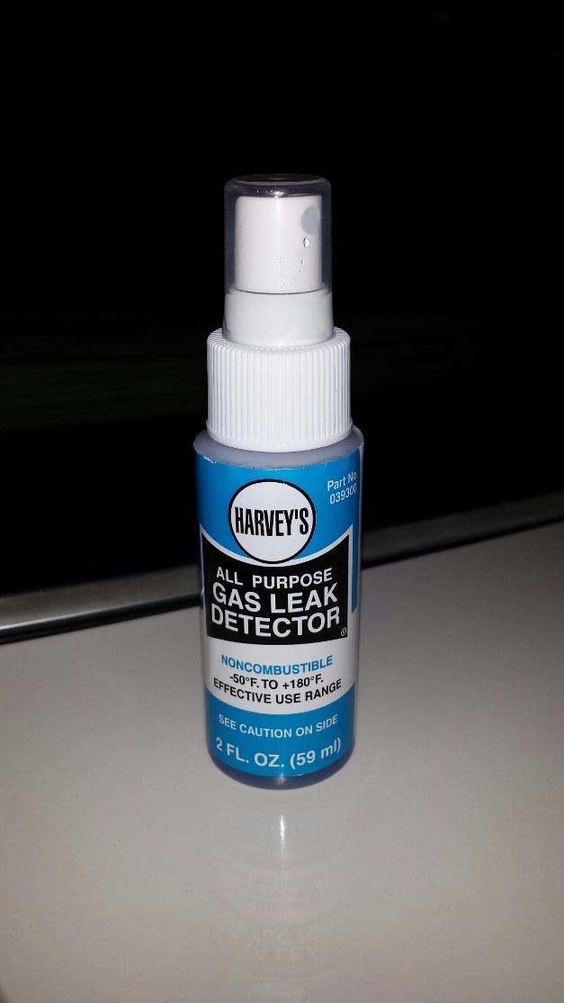

My Cat has been hibernating in the garage for the past 2 weeks.
I left her outside this past Wednesday night and the front end was bottomed out by morning (13 F). Pulled it in the garage, warmed her a little and the front end went back-up. I sprayed "Leak detector" on the air-line/brass-fitting and found a leak. I had to replace a torn O-ring in the brass fitting on the left shock. I know it is not the compressor since it was rebuilt this past November. Will take her out for a trot when the freezing rain stops and the roads are safe.
Attached Thumbnails Anyone replaced their Jag's air suspension with Arnot coil spring conversion kit?-leak-detector.jpg   Anyone replaced their Jag's air suspension with Arnot coil spring conversion kit?-torn-o-ring.jpg
