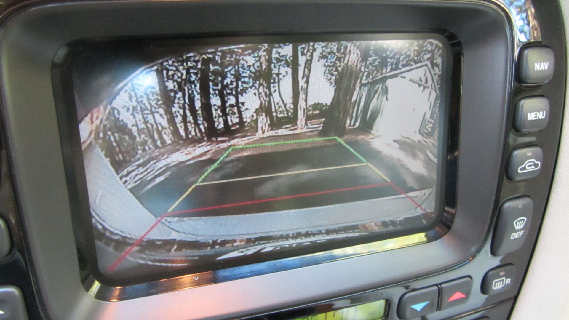

Well, the older I get the more I tend to run into things while in reverse. The 80 year old doctor that used to own my car evidently backed into a rock wall on the drivers side. Even though it was just pits in the left bumper and chrome it cost a little over $1,000 to fix it.
I took my car into Paradyme Sound & Vision in Sacramento. $949.90 later I had a license frame mounted camera displaying on my factory navigation screen when the vehicle was in reverse. The unit I bought has a control mounted on the top of the little cave to the lower left of the steering wheel. You can't see it. It allows you to move the camera up, down, left & right. Also it allows a standard view or a view with parking lines. It does a lot of other things but I chose to go with the lines (which are adjustable for all three zones in both width as well as distance) and I set it's default to go to that setting every time I'm in reverse.
The install included a Boyo VTL275HDL License plate camera in chrome made by Vision Tech America and an interface.
Even though I have front and rear parking assist on my car the video will be a welcomed addition.
Dan

Interesting Dan and quite nice. Can you list out the components they used for this set up?
I've read where others have added a backup camera but have had to manually change the navigation menu each time they put the car in reverse in order for the camera to work.
danveenstra (09-10-2014)

How is the screen quality of the backup picture on the screen. Others have noticed a very grainy look, fuzzy, or a interference line showing on the screen with the systems the have installed. Yours looks very clear and great. Do you have a picture of the control switch.

Besides the Boyo VTL275HDL camera mounted license plate frame there is an interface. The interface is shown on the bill as NAV RGB2+. Price for the interface was $350. I do know they extended the wire that went to the remote control unit which was mounted to the lower left of the steering wheel. I bet if you went to the one of the most popular auto stereo/auto video stores in your area they would recognize the interface NAV number RGB2+.
Everything works on the factory navigation the same as before the camera install. They basically ran the license plate wires to the navigation system in the left side of the trunk by the CD changer. The only thing that was run forward was the remote control. Dan

Sean, The video is in high definition and color. I don't see any problems with it. I think it's as clear as the back up on my new Subaru. You also mentioned that the other units you are aware of had to be manually set up each and every time the car was put in reverse (after turning off and on your ignition, I assume). With this unit you choose what you want to see every time and then hold in on the center "Set" button for 3 seconds. By doing this, the screen you are looking at is set as your future default. Every time you hop into your car, turn on your ignition, and put it into reverse you will see that same default screen. As I have mentioned, I chose to set the default as rear view with the parking lines. Also, the parking lines can be set longer/shorter and narrower/wider to suit the size of your car. I'm telling you, these Vision Tech America guys have it down. By the way, they have a video on their web site that demos this camera. I don't know if this forum allows links to companies web sites but you can Google them as Vision Tech America.
Dan
